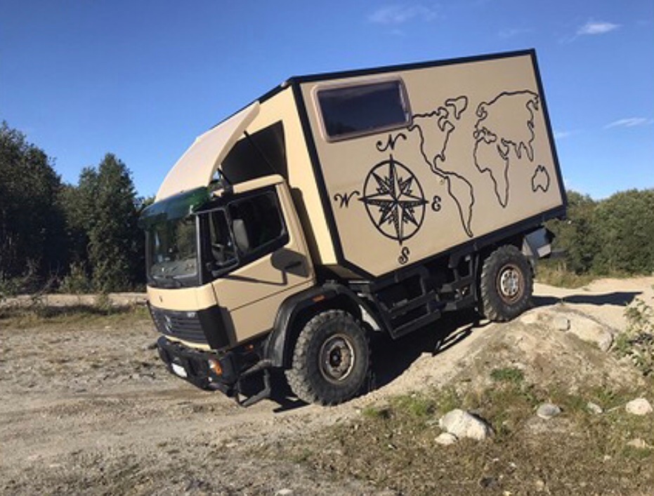

I hope it’s okay to post in English here I have a MB 917 with a OM366A engine. I have seen them upgraded to OM366LA for more power and then change for the high speed axles for increasing the speed, but is there a different way? Is it easy enough to swap for a newer OM900 series engine for power and lower fuel consumption? Is it at all an idea to look for higher revving engines like a Duramax to get speed “the easy way” or am I far off as the torque figures are not usable for a higher revving engine and it probably wouldn’t work very well?
My 917 is built as an 4x4 Overlander that weighs in around 7tons as configured. I don’t know the axle codes, but it likes 80km/h and 90km/h seems to be pushing it
Not sure if engine swaps are common on these and how easy it would be to adopt a new engine to the configuration.

Thank you for the reply. I do want to add that I know the main difference between the size, weight and build quality between a transport truck’s engine and a smaller lighter personal truck engine. But as my 917 will be used as anOverlander truck I do not need the 1 million km rebuild intervals even though it is a plus Also there may not be a huge difference in the rpms, but I do believe a duramax, Cummins or similar may be easier to tune for a little bit higher rpms that again solves the max speed - or am I completely off tracks?
I hope to get some insight as I’m sure swapping the OM 366 with something else must have came accross somebody else’s mind before. Not that it’s a bad engine.. Perhaps the clutch gearbox input shaft combo is not very adoptable for other setups.. I have the integrated 4x4 gearbox in mine, but I have heard there’s an external transfer box that works with a regular 2wd gearbox, if the gearbox needs to be swapped with the engine.

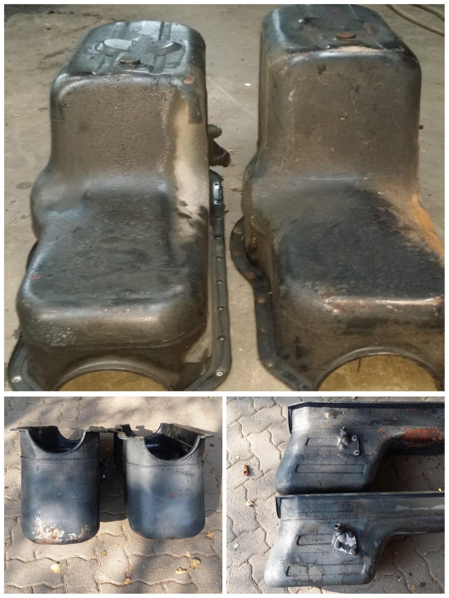

What separates the 156 HP, the 170 HP from the 211 HP or 240 HP type varies gradually over many designs, and years. I think few people oversee design changes completey since the Merc-Guys have retired or passed away. Of course you know that the mode of functioning of thermal engines means to optimize the engine itself as well as its environmental components. Harvesting more power from one and the same basic engine implicates that additional heat needs to be taken away (to finally ventilate to the air).
The strongest permorming OM366 can have either:
The gentleman I had the pleasure to learn from all the above listed contributions told me that novels could be written on this topic. Allegedly there were 300bar EURO-III test version for USA, no idea if that arrived @ production stage
I think some BOSCH-Services know how to tune the injection pumps and pimp the engines. I have no reference. To simply adjust only one feature of the engine-system could mean to have even less power, it is the sum of many and the right measurements which make it work more performing in what direction ever.
I am a learner too and just share what I have soaked up so far.
So no guarantee on accuracy both and completeness
to meet EURO-II requirements the latest OM366 had turbo-charger both and intercooler
Generally speaking the (O)M366 is listed in the EPC in 16 categories (different truck categories/industry/domestic both an foreign markets/LPG/...) with total 327 ! designs (German: Baumuster).
- a bigger oil pan
- a bigger water cooler or other grid designs
- another fan wheel with either simply more wings or a different wing design
- different pistons
- a different internal set-up of the diesel injection pump
- different injector nozzles
- different turbo-chargers (geometry of compressor blade wheel / turbine wheel), with or wihout wastegate
