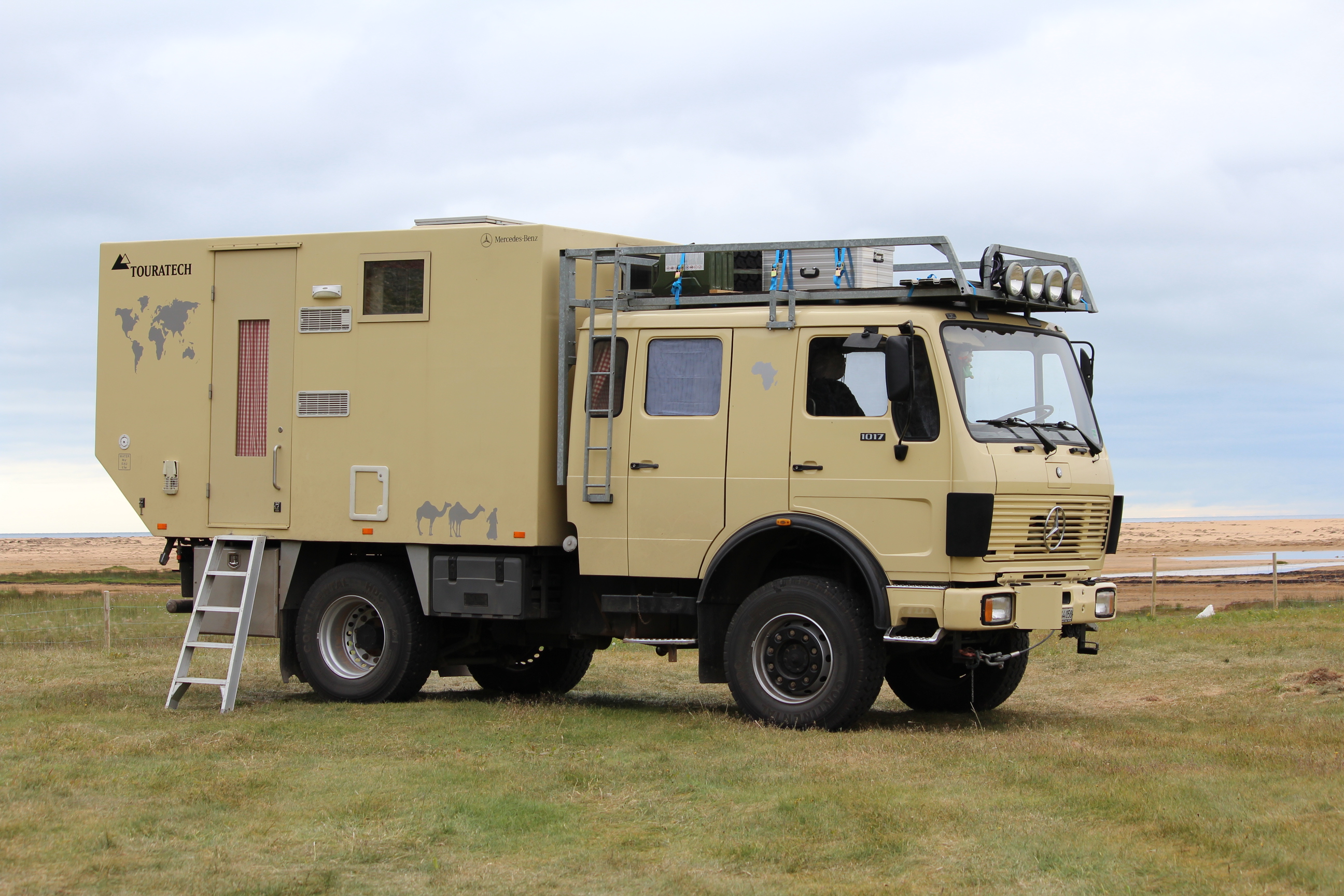

Gerne überlasse ich Euch natürlich auch noch ein Bild von unserem Schätzchen... :spiel:

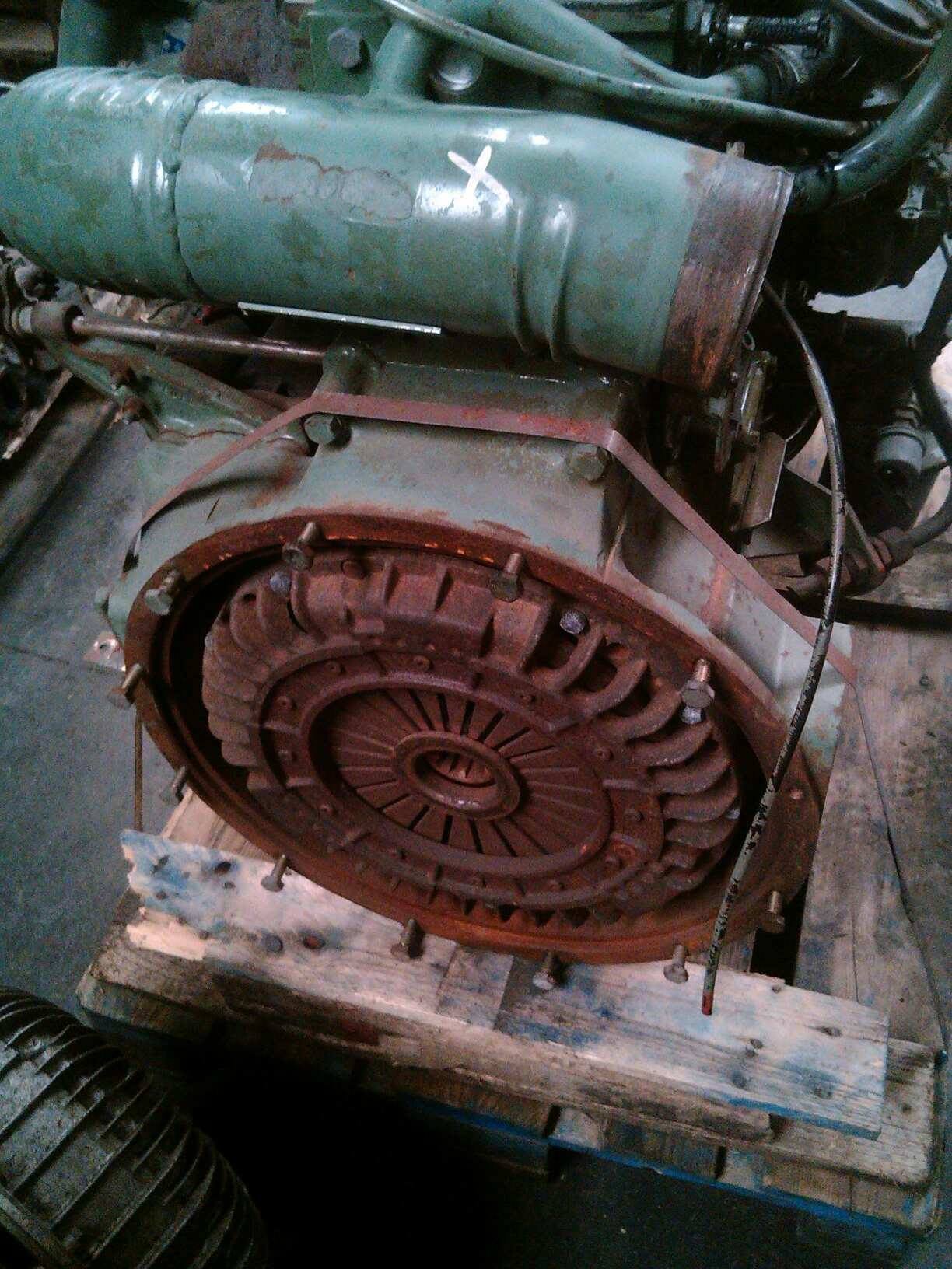

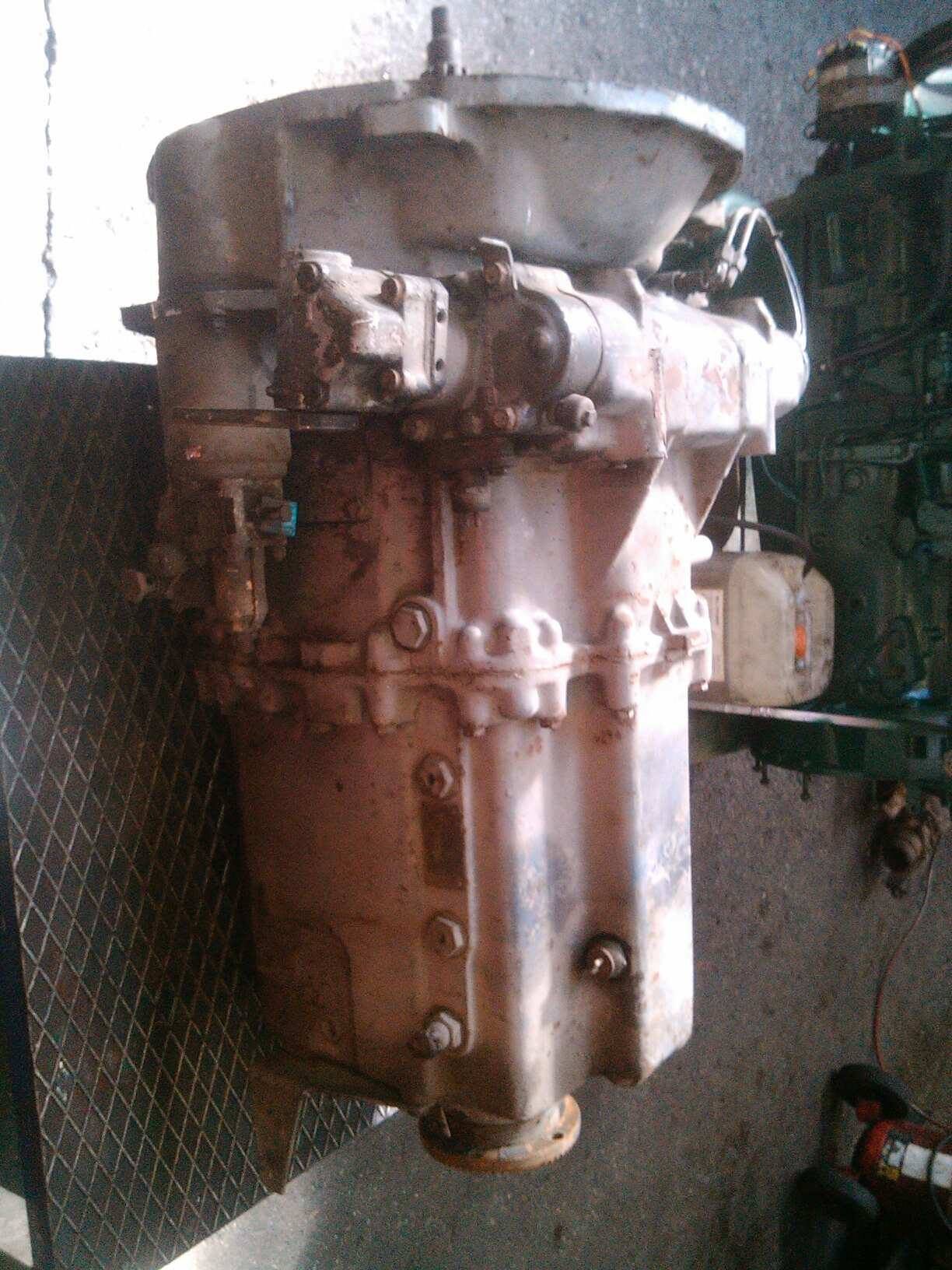

I would also like to swap gearboxes and i found a OM 366LA from first generation with a GV4 65/6-9.0 with PTO, flywheel housing A3522512601, coupling plate GMF350x here in my city.
The engine block looks like my OM352A (A353.972.xxx) but i would like to know if everything will fit before i buy the gearbox and all parts except engine.
