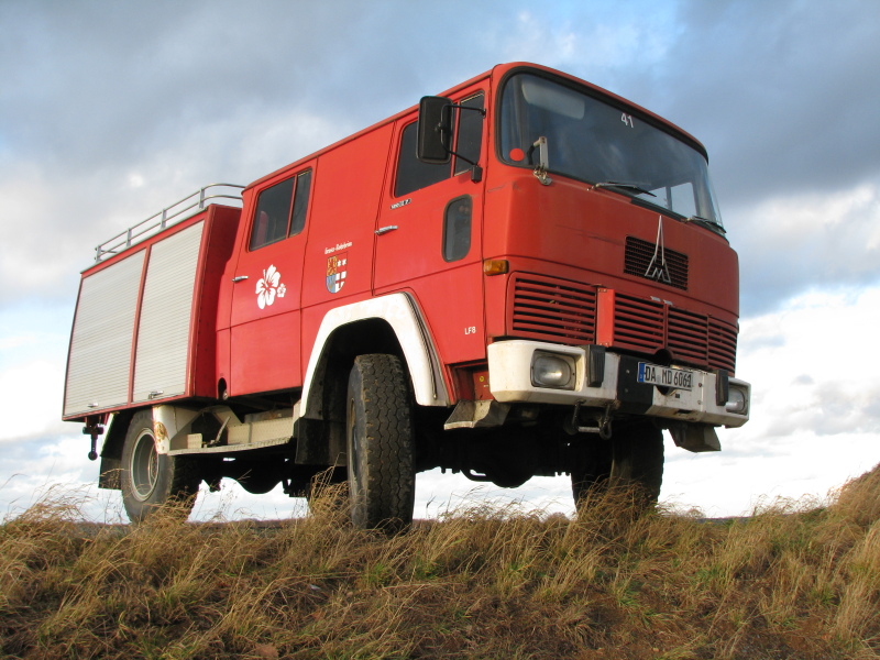

hi peter,
we used different, wider rims for the bigger tires. the original rims are too narrow for that tire sizes.
finding the right rims will need some work and/or some money (or some luck) and its one of the most discussed topics here: 8 bolts, proper rim offset, load capacity and clearance for using it at a truck (for example agricultural or construction machines may have fitting rims, but its likely they are not allowed to be used at truck speeds) etc. .
i'am out of that tire-topic since many years, others will have better information.
on the smaller magirus 120 i liked the 12.00R20 trailer tires on rims from the russian SIL 131 (aka "russenfelgen"): very good in the desert and very smooth and fuelsaving on tarmac - but completely useless in wet meadows:
