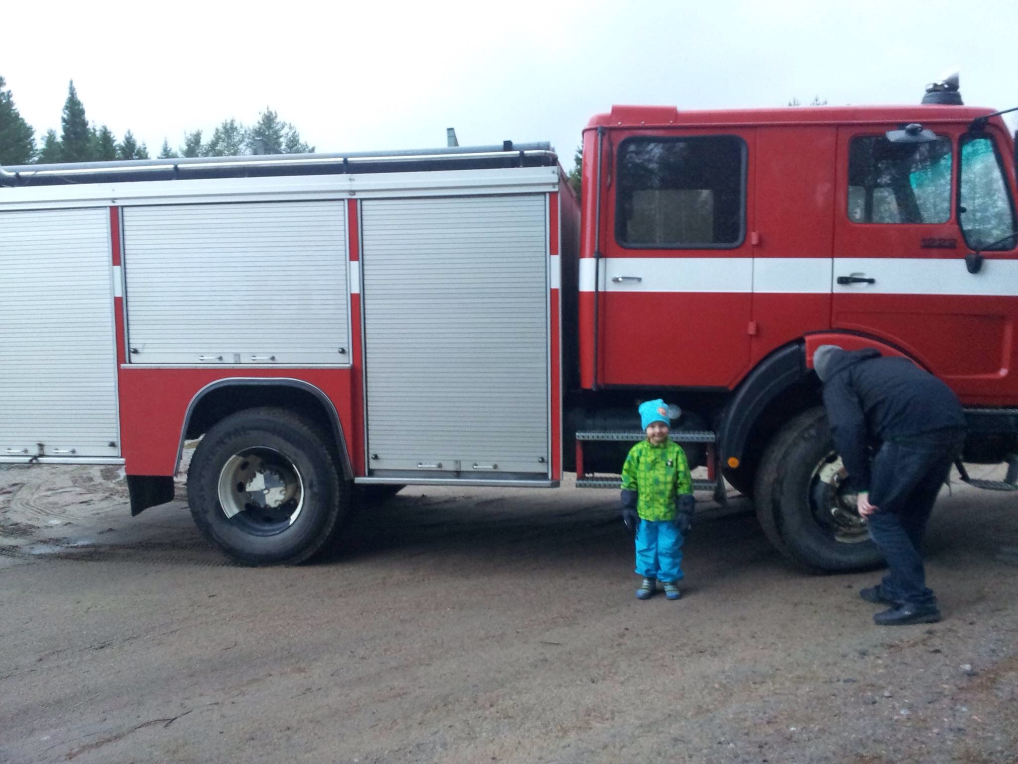

Ok, now it's done. Found one relatively nice truck and bought it. This is my first step towards expedition camper ownership, and I feel uber happy and affraid at the same time
There is no diff lock on front axle after all..
