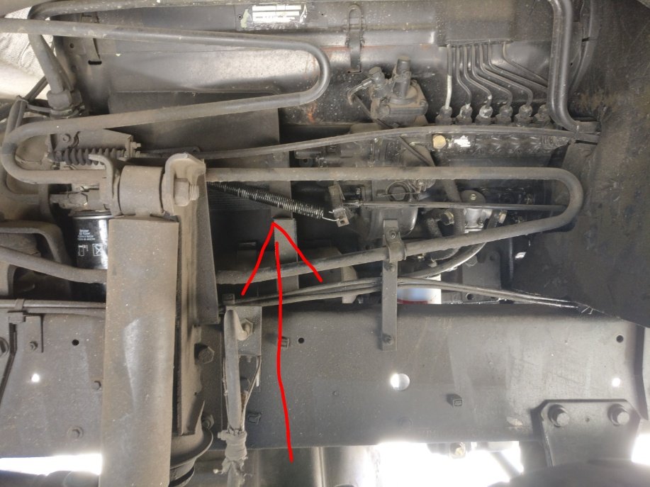

I have been searching everywhere for a throttle pullback spring for my BF6L913 (in a Iveco Magirus 90-16). I want to replace the spring because when I let off the gas, it sometimes doesn't drop down to idle but stays higher in the rpms. It seems after testing like the spring is too loose and lacks the force to pull the throttle all the way back. I have attached pictures.
Does anyone know the part number for this spring? Deutz doesn't have it, they say it is Iveco or Magirus that sells it.. I've been going to 10 different parts stores today but no luck.

... Gutekunst Federn hat Federn nach Anforderung ... oder einfach einen Gummistraps, wie er in meinem Hano an der Stelle jahrelang funktionierte ... davon hat Biltema in der Abteilung båt reichlich, eigentlich zum Segel einbinden ...

in most of the cases the joints of the throttle linkage are rough running so the spring is relatively toothless. Or the mounting of the pedal ist rusted.

Thanks for your reply. I will check the whole throttle linkage, I zeroed in on the spring because I found I could pull it back further. But will try some of the recommendations above if the problem persists.
