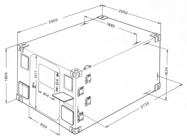

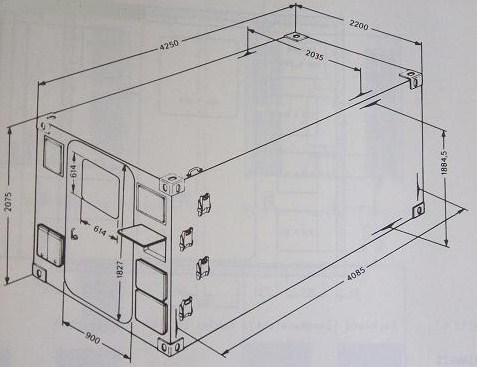

I understand that there are two sizes of the makes of cabin. Is there a posting on here with all the tech drawings? I had looked but could not find.
Am I correct the Dornier versions have blow heating through the small holes in the walls and this is a diesel powered system and the Zeppelin also has diesel heating but through tubes/boxes?
Both have foam insulation but will need some more to avoid cold areas unless open windows and woodstove.

#2 Beitrag von Luigi » 2011-05-28 23:09:05
Hi Woodsman,
please give me your email adresse via PN, I´ll send you a technical data sheet from Led Zeppelin - unfortunately in german - but the measurement you´ll understand - but its metric system!!! Not in gallons, horse-length and stone cast ;-)))

Has anyone made an extendable roof section on these cabins? The reason I asked is the Type 1 seems to be a low internal height (1660mm) but more suitable for hard travel on a vehicle loadbed.

hello woodsman!
if you worry about the isolation... then your choise should be the flying cigar! dornier has many coldbridges between the aluminum layers (outside to inside)
i say, take the bigger one. like LUIGI. well, if the loadbed isn´t long enough it might be a problem, i agree. cutting, extending and shortening the shelter is possible but it depends on how much work you want to put into the project.
