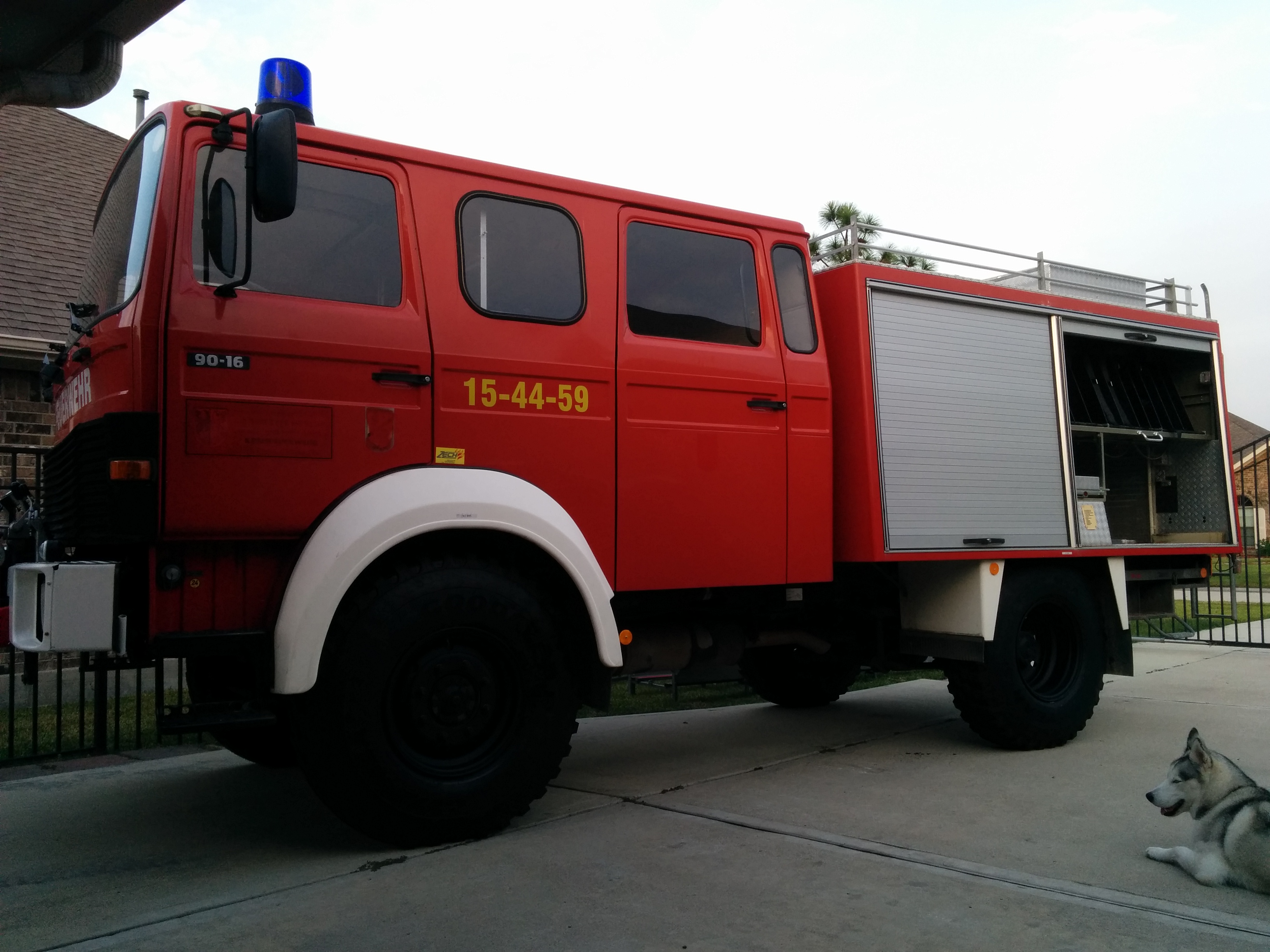

Hey guys hows it going. Well I have finally completed a few things I have been wanting to do on the truck. Thought I would post a picture for you to see.
I fit some 12.00R20 tires on it on some 20x10 wheels I had refinished and powdercoated. Also removed the huge side steps for much more ground clearance. I also took the tall ladder racks off the top and just left a few inches for storing items up there. Looks much more tough!
I am thinking about painting the fenders and front bumper black instead of white, but I havent decided on that yet. I am also going to remove the water pump up front but so far have only pulled the driveshaft.
For the guys that have these, are there any common failure points on these I should be looking out for?
I am planning on some long trips coming up but dont to oversee something that can leave me stranded.
This one has only 30k kilometers on it, I am hoping there is nothing too wrong, but I wanted to ask some forum members what to watch out for.
I changed the oil and checked all fluids, however I also want to bleed the brakes, how is that done on these with the air over hydraulic setup?

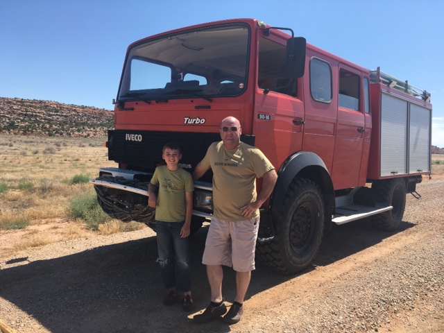

I also have a 90-16 in the US. I am located in WY and have had the truck for only a short time. I had wheels custom made for it and am currently running Michelin XZL military tires as a super single setup. I am hoping to get a copy of repair/service manuals in hard copy or electronic. Does anyone know where I can source a set?

Thank you for the response. The truck is a lot of fun and we have used to to travel around the American West. I look forward to being a member on the forum. Danke
