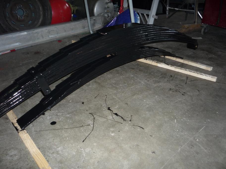

#6 Beitrag von Tim911 » 2011-03-19 9:19:48
Thanks guys for all the info
We found a compagnie who reinforce the springs
they also curved the springs.
Next project the engine en a servolenkung
