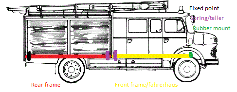

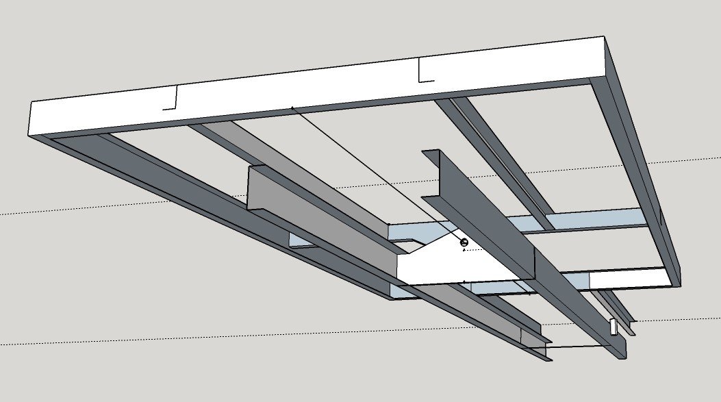

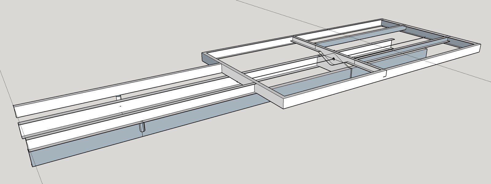

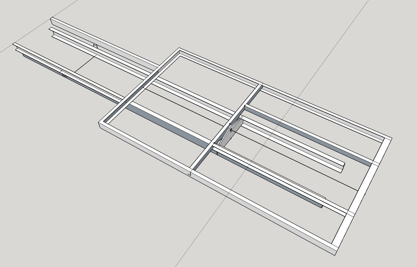

Having looked at how it comes from the fire department makes me wonder:
(Excuse the crude drawing)
There's in effect two separate frames on top of the chassis with the springs/tellerfederung tightened so hard, there's hardly 10mm's of movement possible. The frames separate just behind the cab.
In my mind that leaves very little room for frame flex, and concentrates it in one spot, right behind the cab.
I can come up with a few reasons why it was done so:
1: A fire truck will not see hard terrain, so a more flexible solution was not needed?
2: The service life of a fire truck includes very few kms, so the stress on the components was acceptable?
For our use there's a few things I would like to do better:
1: As mentioned we want to integrate cab and box.
2: To isolate cab and box from the frame to minimise noise and vibration.
3: Spread stress along the frame

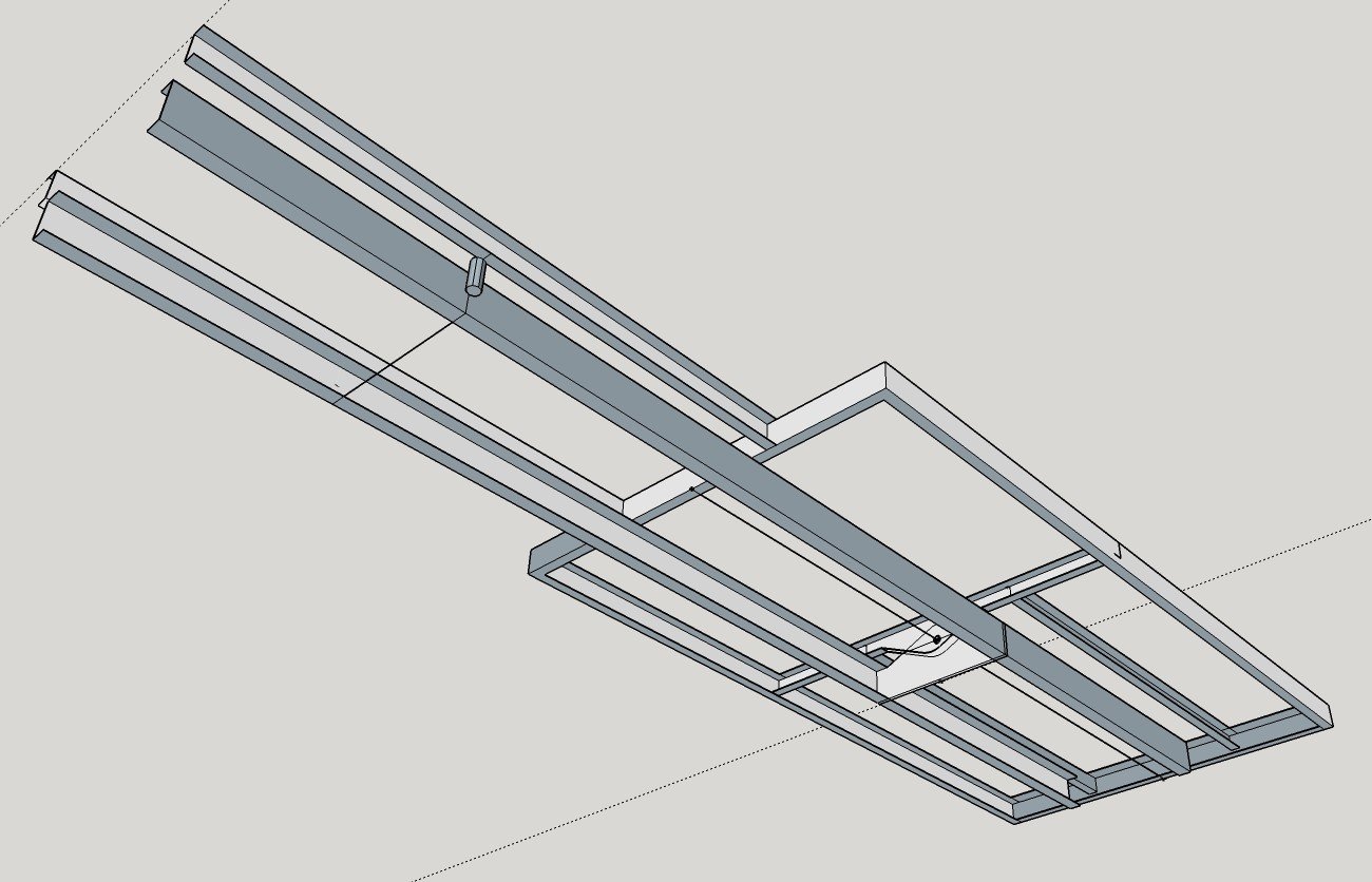

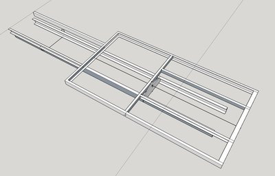

My idea is to make a subframe extending original cab, somewhat like it was done by the builder, but all the way needed for the camper.

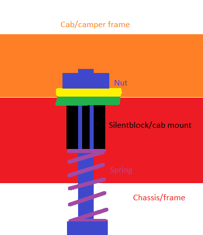

Then I plan to use cab mounts/silentblocks and start where the original cab mounts are.
Longer back I would make a hybrid mount using a cab mount but with a longer bolt and put a spring on the bottom. This would keep the cab/camper securely attached while vibration isolated and at the same time allow the frame to flex in terrain.
Cab mount.png (10.92 KiB) 4890 mal betrachtet

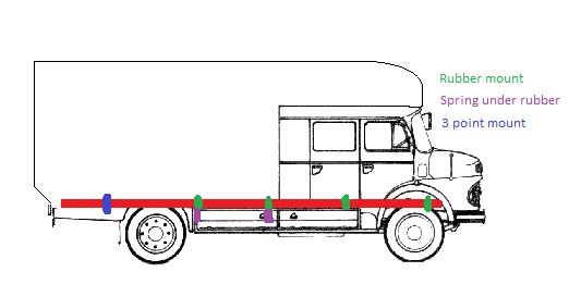

Furthest back I would like to use a vippe like in a 3-punkt lagerung and incorporate either cab mounts or a usable rubber/poly bushing.
But it would have to have enough vertical movement to account for the springs when flexing... Have to think about that some more!
What do you think?

Hi Christian,
have lots of fun with your mercedes :)
Regarding your question:
I think the 3 point mount behind the rear axle is rather useless since the frame does not bend anymore behind the rear spring mount.
The main point of your construction ist the integration of Doka and Cabin. First, this cage has to be stable enough to resist the twist of the frame, independent of the mounting. Second, the mounting points have to be stable enough to keep the cage on the frame even when twisting.
The Magirus way of setting up an integrated structure on an awd chassis was to separate hood and wings from the rest and built a classic 'Federlagerung' for the rest of the structure. Unless you do not want to keep the frame from twisting, this might be the best way :huh:
Best

Thanks Uwe!
I think you are right, and the more i think about the 3rd mount, the more I realize it is either unneccesary, or extremely complicated to do, if it should work correct with the cab+spring mounts.
Besides, the cab mounts should be sufficient to keep everything in place, that is what they are made for. So the best way may be to contact a manufacturer of cab mounts and ask them.
Just have to figure out the approx. weight of the cab and box....
I will look in to separating hood and wings, but it might not be necessary, they are really short.

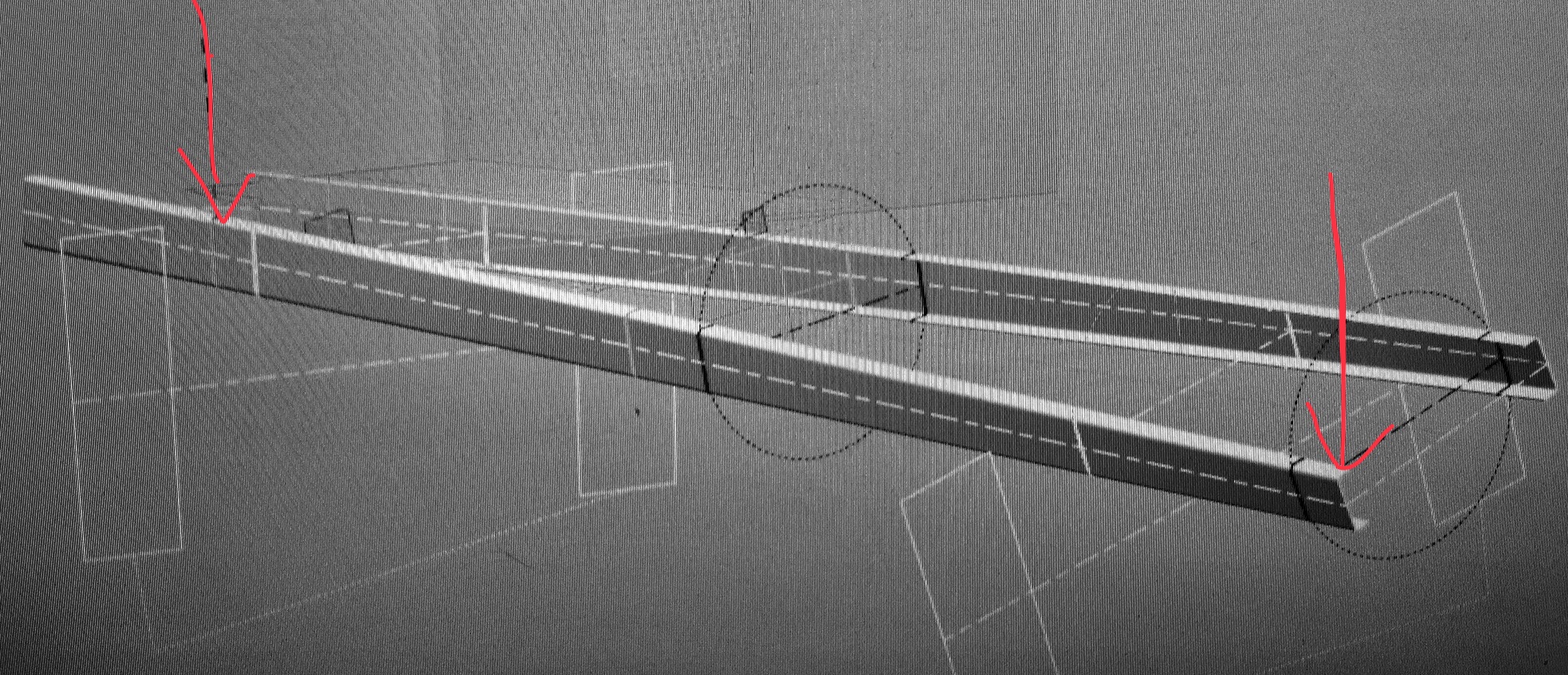

Sasha71, your numbers and drawing actually shocked me! I need to find a proper drawing of the frame to do some sketches...
Thanks again guys! :unwuerdig:

Based on some of your recommendations, I have come up with an alternate idea, keeping the 3-point system, but making better room for the frame.
Please note that these are just scethces, and no measurements are remotely accurate, just a test...
The idea is to keep the silent blocks up front, and have a 3-point system in front of the rear axle (with silent blocks included, but not shown here), to minimize the amount of flex exerted at this point.
The reason for this is to minimize the needed clearance around the frame. And for the same reason there are no subframe or other parts between the camper box floor and the frame right out back.
Again, the goal is to integrate cab and camper box, while minimizing noise and vibrations in the entire system.

Has nobody seen something like this?

Hey,
to be honest i would fear this construction will cause a terrible drivability on streets. Due to the "Wippe" in the middle youre body will lean heavily in curves.
So does my "Einheitskoffer" with this mount in the front of the box and two fix mounts in the rear. But youre body will be far more topheavy and even longer.
If you want to construct with that much effort i would use two "Wippen" perpendicular to yours above each framerail at the front of the box - and one orientated like yours at the end of the frame or above the rear axle.
Further i would beef up the front rubber mounts for some that can take more load and more flex.
Freddy

Thanks Freddy!
I agree that especially round-a-abouts would be really bad.
I saw one who stabilized the rear using airbags between the chassis frame and subframe. The idea was to keep them inflated on the street, and deflate in heavy terrain to allow the chassis frame to flex.
That might be a simple solution.
I am not sure what you mean with the perpendicular wippen, like rautenlagerung?
I have found rubber mounts that takes up to 750 kg each. And they can be installed parallel sharing load.
It is a bit of a paradox that stabilisator is so hard, that the suspension doesn’t flex, and tge frame does it instead.
I am thinking about softening the suspension to better suit the actual load.
