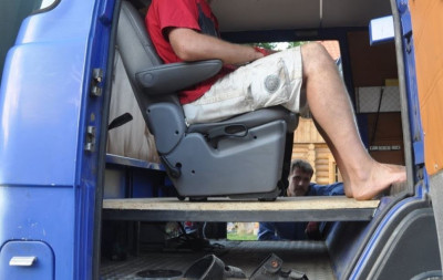

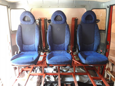

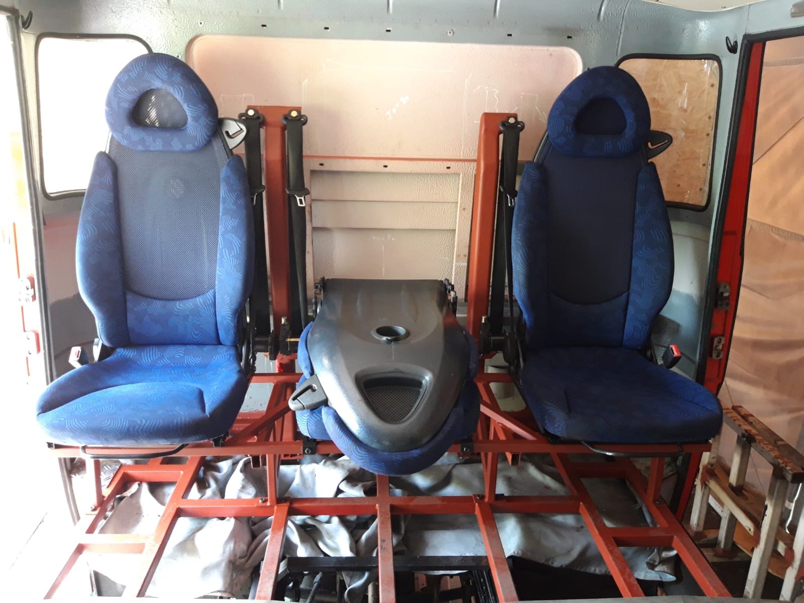

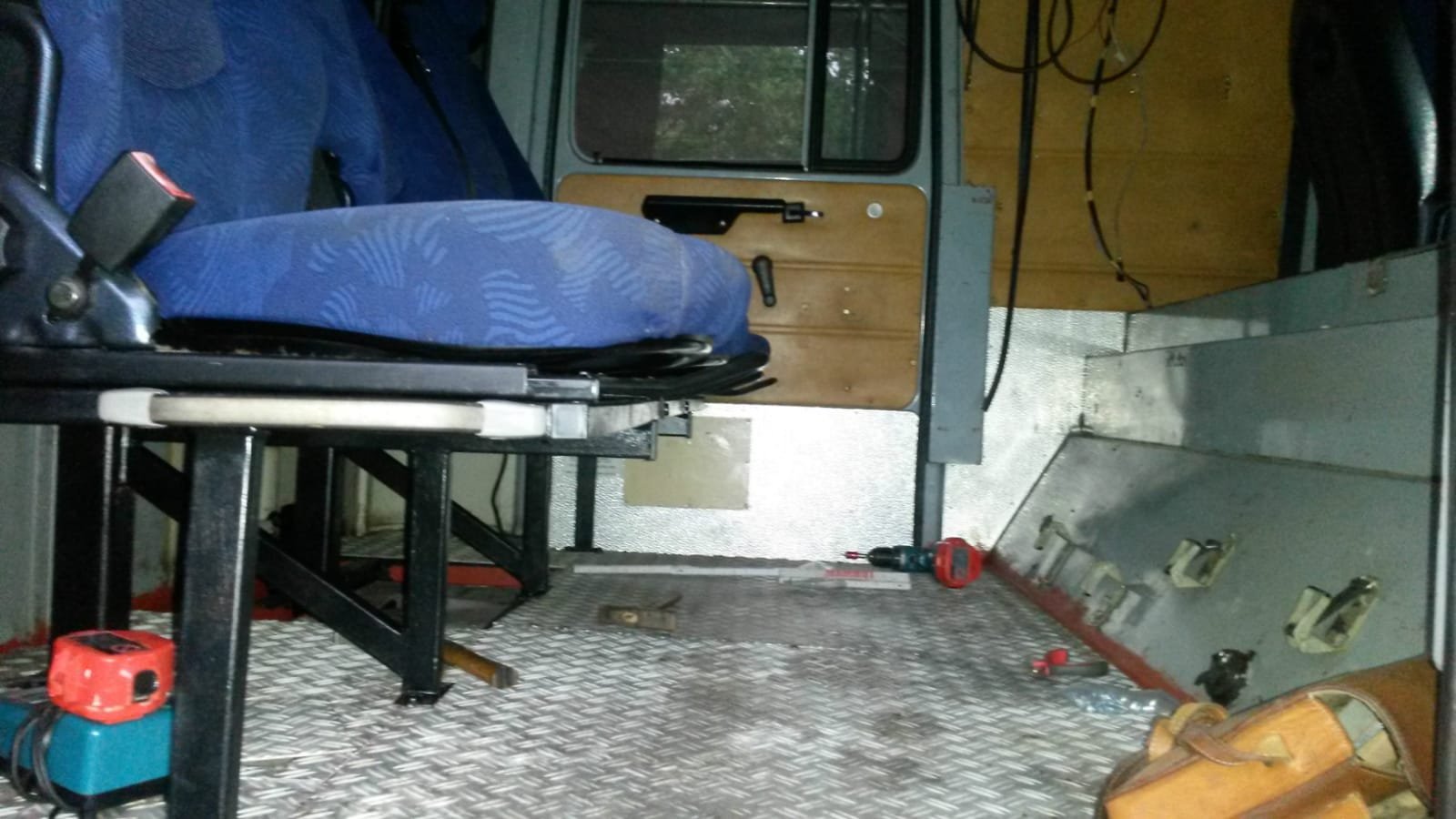

I have got stuck on the installation of two new rear seats instead of the original row. There are two major problems: 1. Legal - it is not allowed to change seat mounts from the original, except with a permission of the manufacturer. In this case it would be IVECO which says that the model is too old and there are no technical database for them to provide such as document. I have had number of discussions with TUV and it seems that it is a bureaucratic deadlock. Only option it would be to change registration from Womo to kind of Dakar rally sports tech support truck. 2. Technical - so if we are looking for a full size seat for an adult, the seat needs to be minimum distance from the rear wall to allow some recline possibility. Consequently the seat moves forward and we got an issue where to put your legs as the middle bulkhead is quite close and high. So I found a solution to rise a subfloor by approx 250mm and cut out bulkhead. To keep cab structurally solid a new square tubular reinforcement below the engine cover level was welded in.
All this, of course, makes sense if we talk about 2 adult full size seats in the back row. Third challenge is the comfort. On a test drive with this seat configuration it was quite bumpy to handle gravel roads, not speaking even about off road. So the rear sets would also normally be at least spring loaded or with an air suspension.
