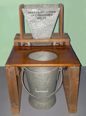

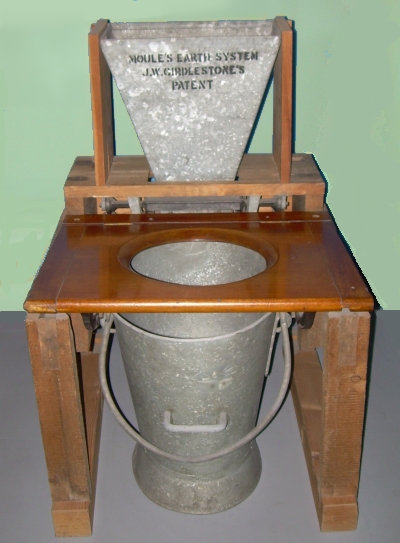

Does not sound good. Need to eat more Bran. :joke:
One of these original portable toilets then no problems even in frozen weather.
