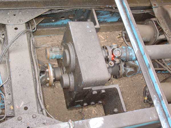

My 1419 has the v-6 in it with G3/90-8/9.29 8-speed transmission. I heard that the former owners broke the transmission and couldn't find one in the US, so they imported one from Germany. Mercedes USA wouldn't swap the transmission for them, so they flew over a mechanic to do the work!!!
So, now i have the truck with a transmission and clutch with ZERO KM on it and a truck with only 106,000 KM!
The truck was set up with a GIANT Woma pump powered by the motor through a Stiebel gearbox (1=1 ratio). The stiebel gearbox is bigger than the transfer-case in Casa Azul (my Ford WoMo). I am thinking of opening up the Stiebel gearbox and seeing if it can be modified to be used as a transfer-case. The only problem is that it would not have a low-range. Do you guys think that the low gear in the G/3-90 8/9.29 would be low enough for off-road conditions?

So i'm not sure what I'm going to do with the 1419. I have a heavy duty transfer-case (rockwell) I can fit it with (1=1/1=2), and I know where a REALLY NICE Marmon front drive axle is....So I have the 4x4 part under control, I guess I'm concerned about the other bit and pieces that could cost me a fortune in shipping from the EC.
Any Suggestions / advice would be greatly appreciated.

Hi to the West Coast,
when I suggested you to buy a drive train I did not know that you already have a fairly new 8+1 speed transmission and the V6 engine.
They are quite reliable and were very common over here with dumpers i.e. modest off road use.
I don´t know anything about the siebel box which you intend to use as a transfer case. Important for you should be to find out about the max. torque input and output for this part. It could be that this would be too small to suit a drive axle. If you decide to go for the try and error method the result would be that you would have to fix an original transfer case.
But I don´t need to explain to you about Dr. Murphy
Anyway the lucky part of it is that in case of a breakdown the rig still stays 4x2 as it was before and gets you back home.
