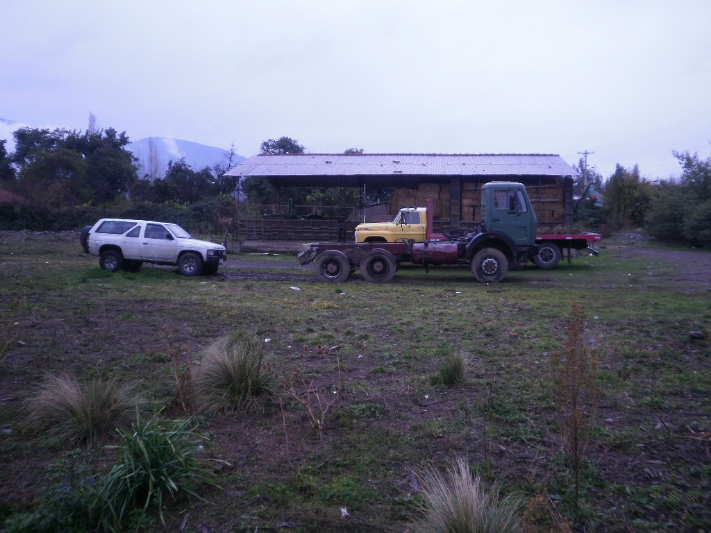

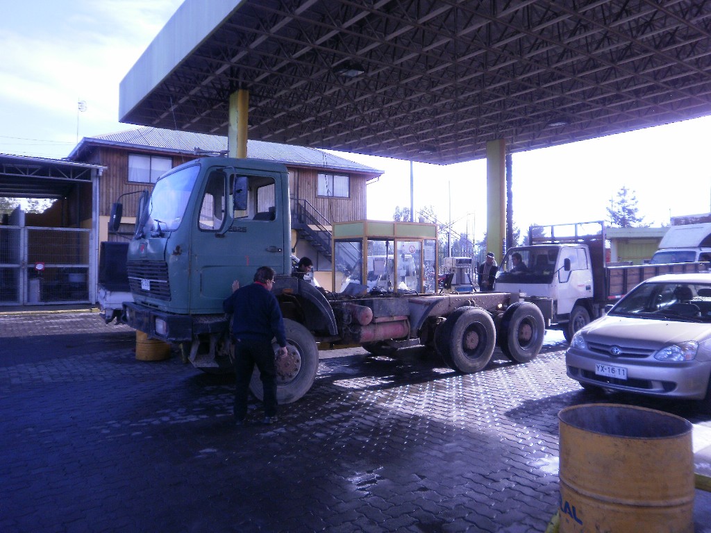

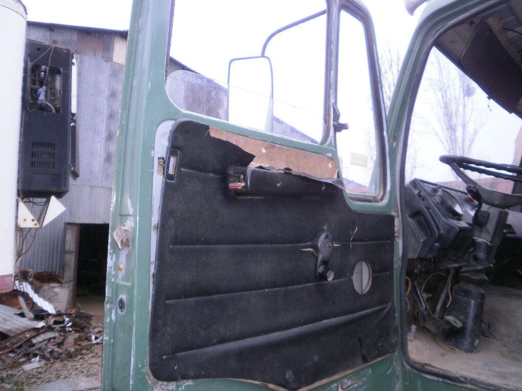

http://img259.imageshack.us/img259/6834/pb170091.jpg
And, for a change, an image of the truck.
Surely there is nothing extraordinary to see for europeans, but in South America 6x6 trucks are incredibly rare.
Needs lots of work (you can see the smoke!), and at present the engine is hanging from the crane, but, manuals or not, it will be running again as if it was its first and fastest trip (at 85 km/hr). After that I will begin to build the habitacle.
Cheers.
Pairoa

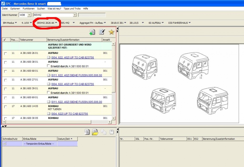

Hi:
After many rounds I finally got the right EPC version. Had to get permision from a friend in Italy to use his adress and register the credit card in paypal-usa for the transaction.
My 2626 is on line now.
I feel a little dumb and like if someone had been playing tricks on me.
Thanks everyone for the help and sorry for bothering.

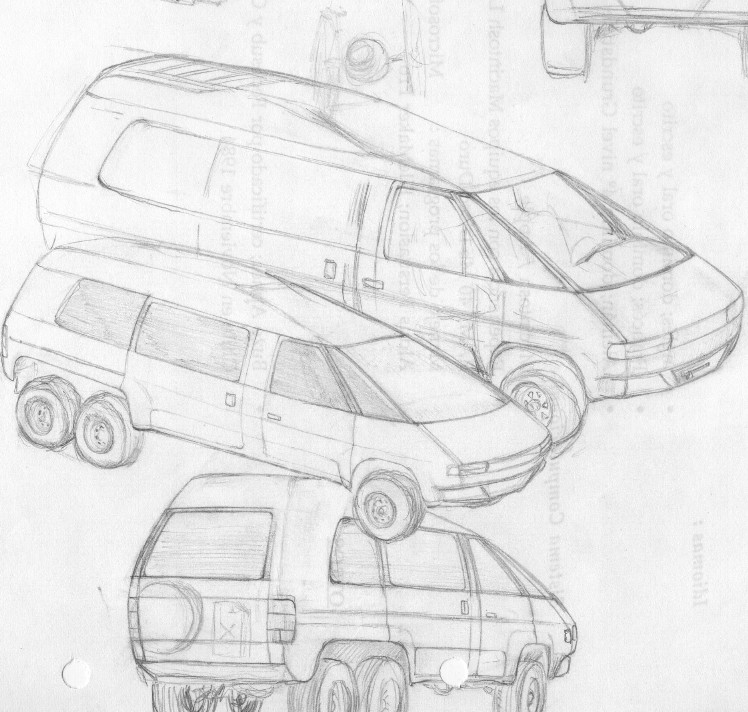

Within the hundreds of designs I used to draw in the school copybooks instead of doing my homework I draw the one that appears on the first photograph, but adding on my own a third axle and shaping it with modern lines. I liked it so much that I still have that page between my stuff after circa thirty years.

When I got home I began to draw the idea that circled on my mind and, to make a long story short, after a few hours of thinking, a few sheets, a little ink and paste and some time with Photoshop and the whole initial concept was defined.

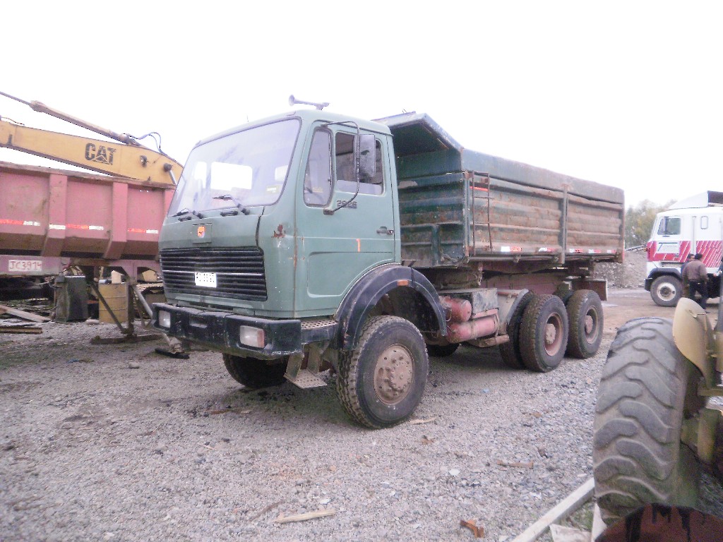

Then, one good day, I found this advertising of an (almost) complete set of a 4x4 Mercedes axles and transfer case for sale. Unfortunately (but not really) the advertising was old and the items were sold months ago, but the site administrator, who found my singular idea at least interesting, searched within a ton of e-mails and gave me an already unpublished selling note of a 6x6 dump truck, with no photos.
I e-mailed the supposed seller and he sent me the photos of the truck. Just by seeing them I felt some tingling in my stomach, the same feeling I had when saw for the first time the Terrano and the Blazers.
Eduardo watched the pictures for less than a second and without a doubt he sentenced:”This is it”.

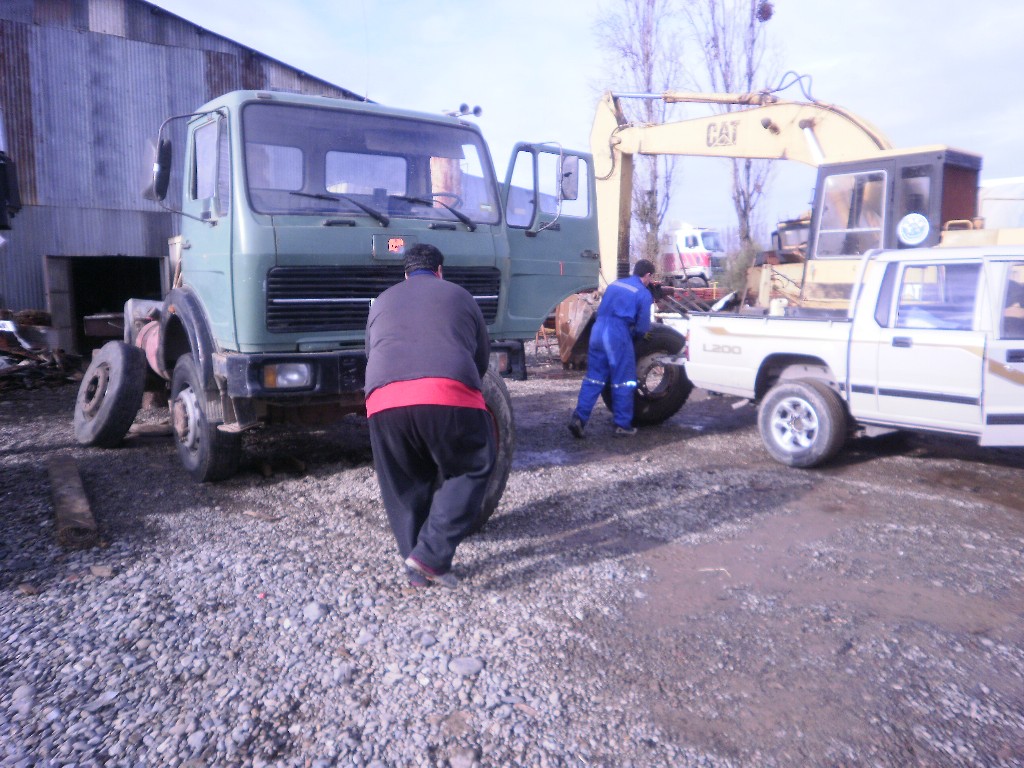

So, before dawn the 17th of june, I, Eduardo, my wife (Eduardo’s sister) and Alejandro (a 200 kg argentinean friend and employee) got the highway heading for Talca. We picked up the truck driver one hour before arriving and he did not stop talking until we got there.
Alejandro was the happiest to get out of the car, a 1992 Mitsubishi L200 4x4, by far the most uncomfortable rear seat of the world. As you will see, Eduardo and I share a crush for old cars, meaning first nineties cars.

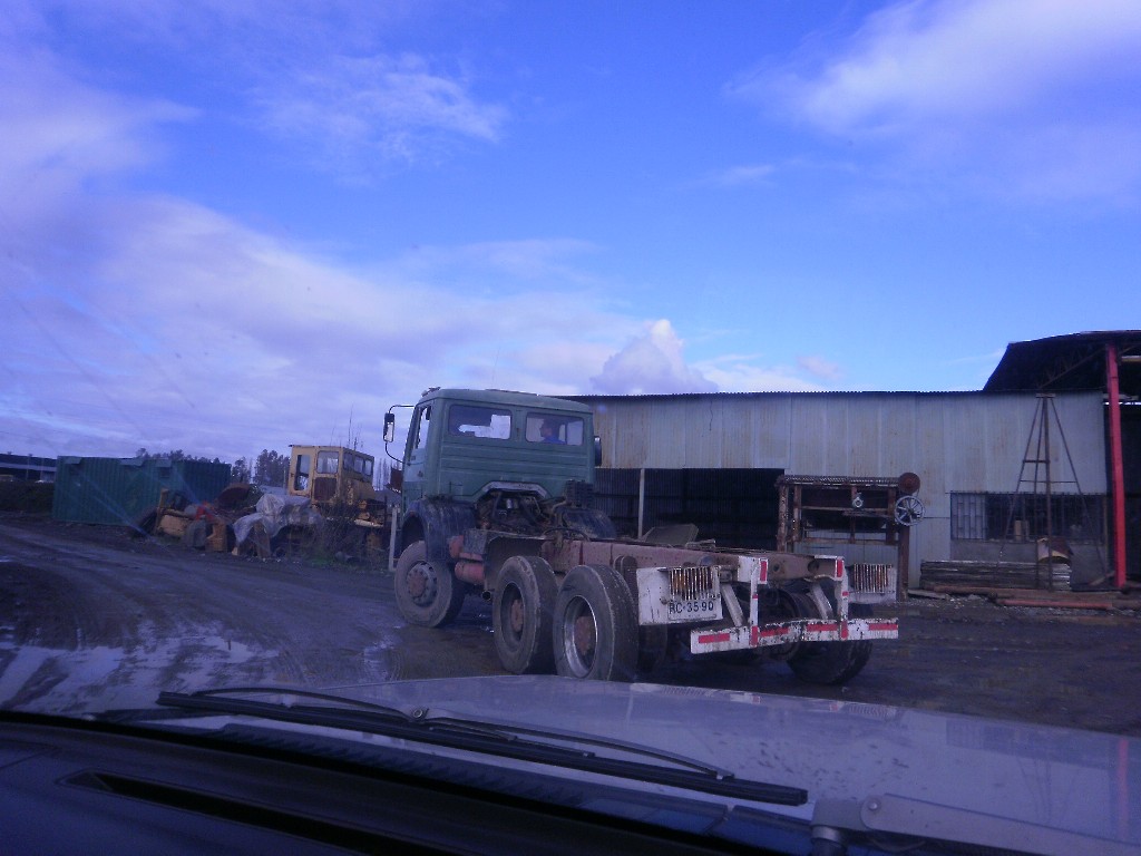

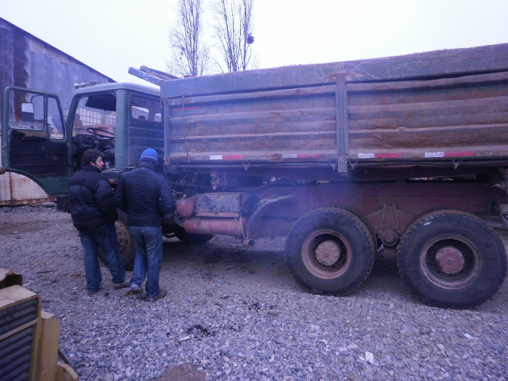

The place was a dumpyard, or almost. The past night rain turned the soil to mud. The truck was not completely on stands as intended and the absence of the dump box revealed more clearly the dirt under which the truck remained for who knows how long. I had a bad feeling.

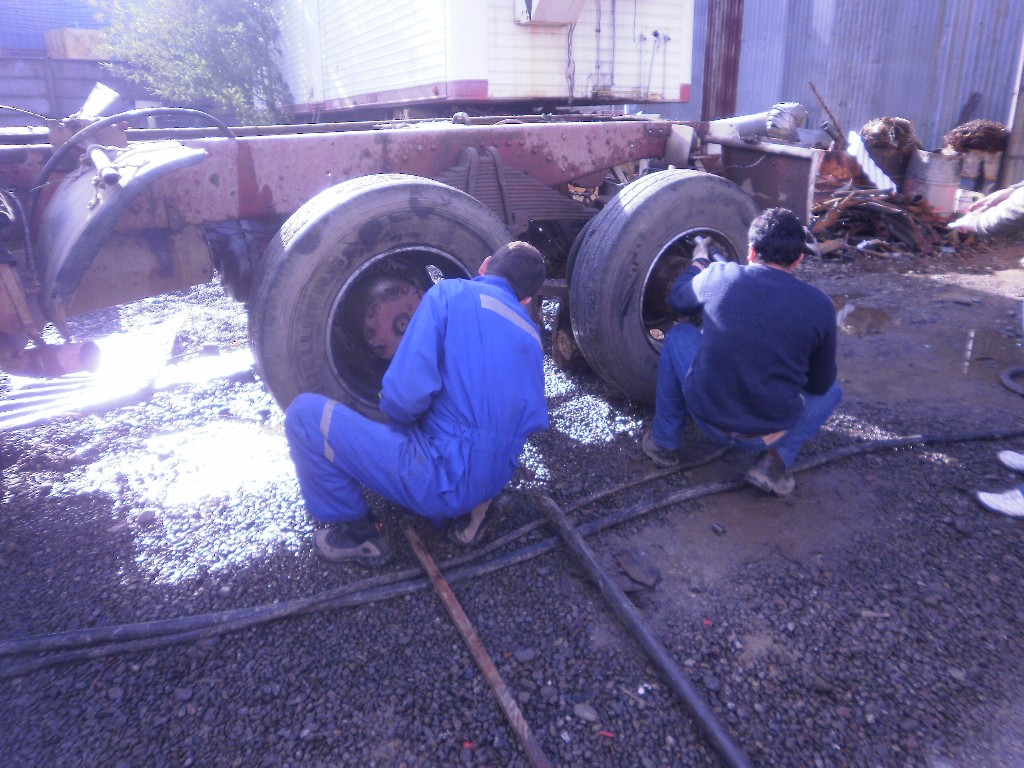

We started to put on the truck the wheels that we carried and to take the rims out of the ones which were there. We had to take them, in many trips, to a man nearby that, with his hands and a few precarious elements, took off the rims without any perceptible effort. He charged for every wheel as he was using the last brand new hydraulic tool, though. Eduardo watched a lot, giving instructions for the safety and care of our backs and hands.

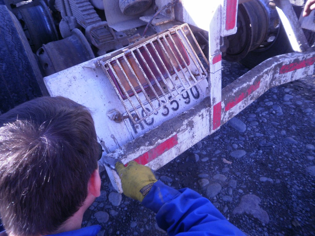

My bad feeling proved right as I realized that the owner took off the Rockinger hook together with the dump box. I love my country but I have to recognize that this is a common practice that I am not proud of. Anyway, the hook ended on the L200’s pickup along with the old rims and the truck started with less smoke than we spected to see. It took centuries to get enough air pressure to unlock the maxis and the oil pressure raised normally though it kept low in ralenti.

After a few hundreds meters, before getting the highway an in the middle of a crossing, suddenly a tecalan failed and the truck stopped in the middle of a cloud of dust. The emergency team immediately took charge and started to look for a solution. Don’t know if it works in Europe, but here almost everything can be fixed with a piece of wire, specially when you forget to carry some brackets. It only took three minutes and I found the wire required on the side of the road (there always is some piece there) and Eduardo applied some skill and fixed the tecalan.
Back on the road the old Mercedes proved to run more smoothly than expected, even without any load. The oil pressure was within range and the RPM allowed for almost 90 km/hr. It speeded up better than I thought but steering and brakes needed urgent servicing. When it came to pay the highway toll I suffered again.
We made a stop by the police to announce that our truck was in a trip for heavy servicing, just in case we were in trouble for the wheels, and they let us continue without any problem.
After 20 km Eduardo called to warn us that the right aft mudguard was hanging from the chassis; it was partially welded before to the box so the stand alone did not hold. Another piece of the same wire and skill and we were back on the road, still smiling. Alejandro took my place and from behind we saw the cabin bend to the copilot side, just a little. We laughed. Alejandro is our friend but he obviously has a weight problem.
Just a few kilometers and the left mudguard also fell down together with the lamps and the license plate and ended almost in the middle of the highway. Fortunately we were behind. Same problem, same semi-solution, but with no laughing this time.
We made a stop for a late lunch in a truck drivers restaurant. Eduardo and Alejandro remained some time staring and admiring the big new trucks parked there, like saying: “These are trucks for real!”. Traitors.
I tried myself to perfection the fixation of the mudguard and worked on the lights.
The rest of the trip was uneventful. When we arrived to Santiago we made a stop to refuel and I dispatched home the driver by bus with a big tip. He was old and started to complain of backpain because of the broken seat. Surprisingly the consumption was far less than I calculated, of almost 4,8 km/lt.
I said that none of us had a truck driver’s license, but we took the chance and arrived to San Felipe with the truck, profiting that the road was almost empty at that time of the afternoon.
The truck did not fit in Eduardo’s workshop (we knew that, obviously) so we took it to the country and parked it there, where it would stand until it was time to begin the overhauling.

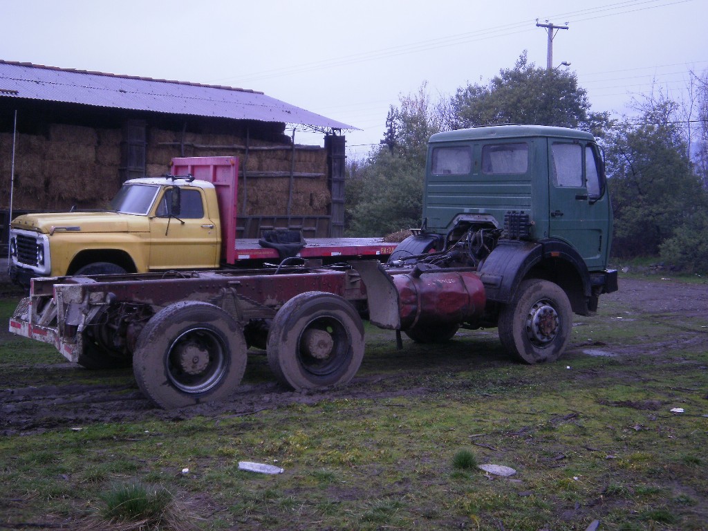

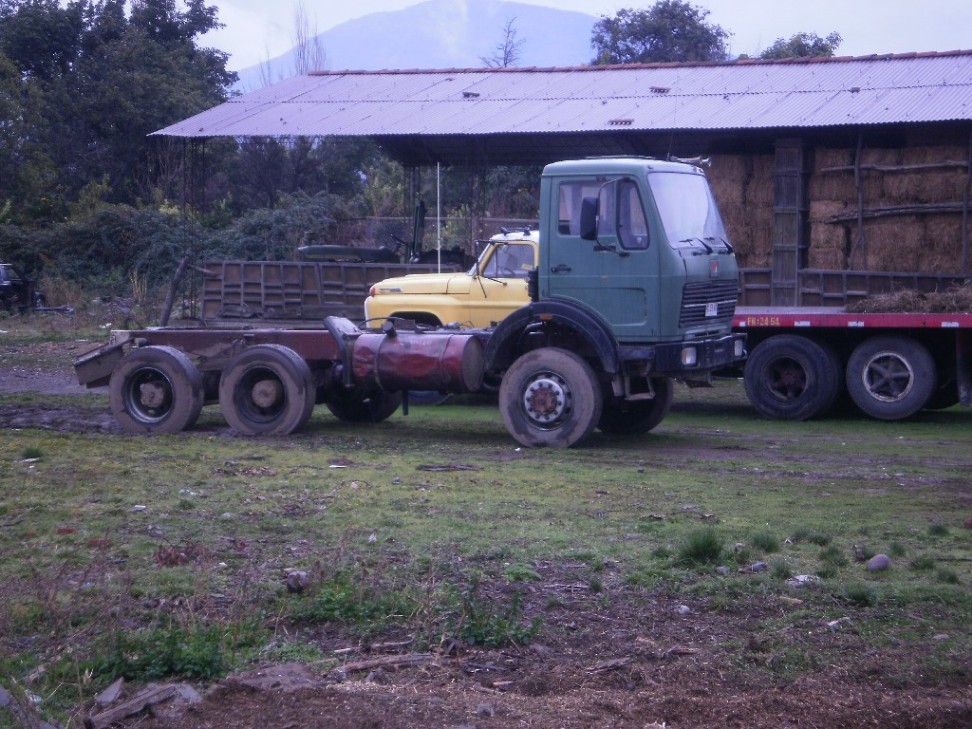

Once in its transitory parking site at Eduardo’s family country-yard, the truck began a long pilgrimage that finally would transform it in an actual object of cult, at least for me.
Its name, Merkabah, came with no sign or advice, as always do occur with things that you believe are coincidences but that in reality they never are. It refers to a mystic object, kind of an interdimensional vehicle to transport, only with the energy of your desire, alone or with company, from one place to another no matter how remote.
Naturely, this particular Merkabah do not fullfill all the requisites of the real one, but maybe it does others; I wish the engine would run only with the force of your desires, with no technical or legal restrictions for its age.
Anyway, it was baptised as such. Later on I discovered that there is even a tank named also Merkabah. Mmmm...
The series of pictures that follow show better some details and the characteristics of the truck, and the need for repairing or replacing many pieces and components. The yellow truck behind the Merkabah is Eduardo’s old Ford, used only for taking the peaches to the buyer when in harvest time. It would prove very useful in the near future.

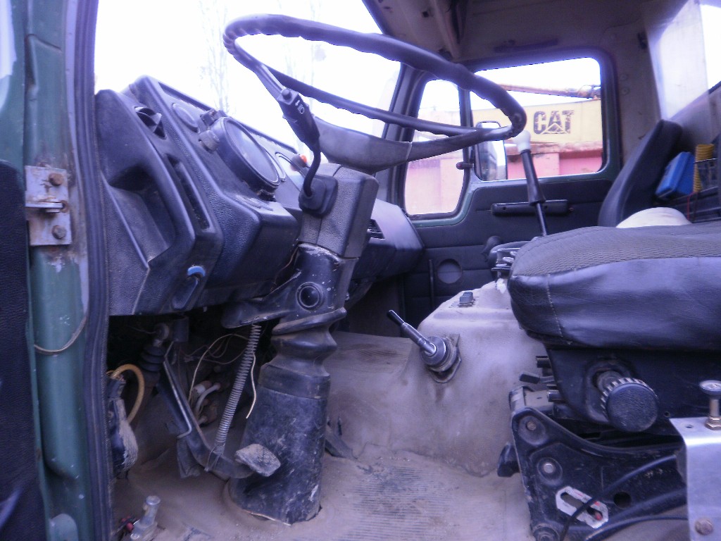

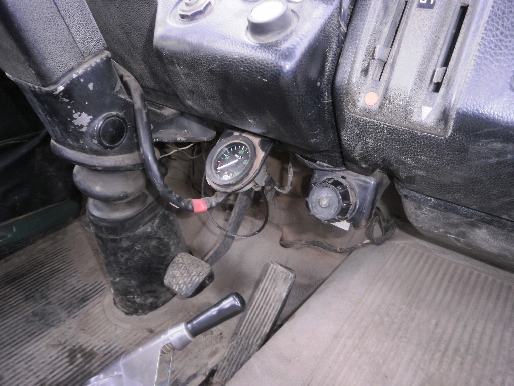

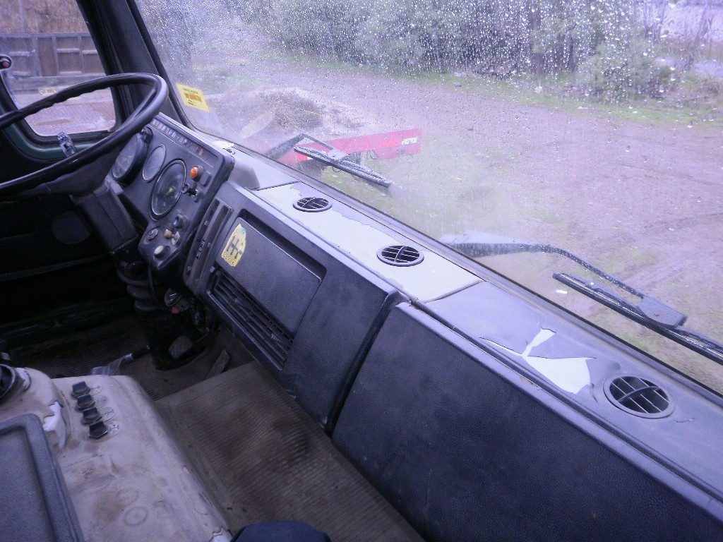

Merkabah’s oil pressure gauge was an insert, though it worked properly. The dashboard was bad shaped, as was the roof. The missing door glass had been replaced by a wrong shaped piece of plexiglass and the knobs were missing or broken. Both foot rests were a mess and the one on the pilot side was even welded to the cabin. The bumper was, incredibly, pretty healthy. You could see the attempts for making up the damage of the cabin.

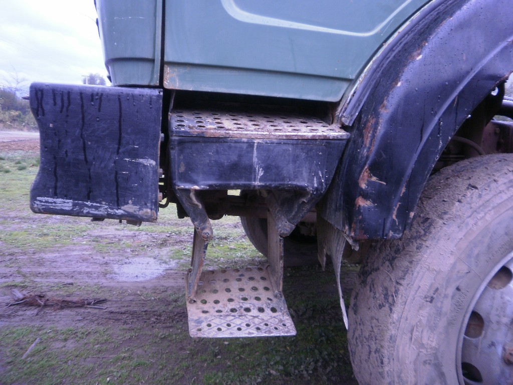

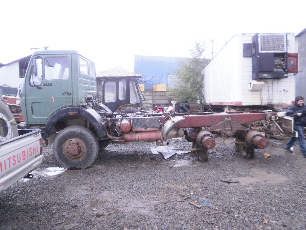

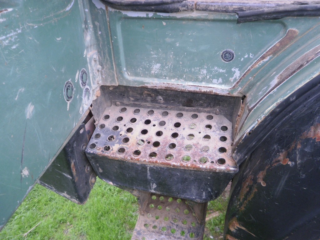

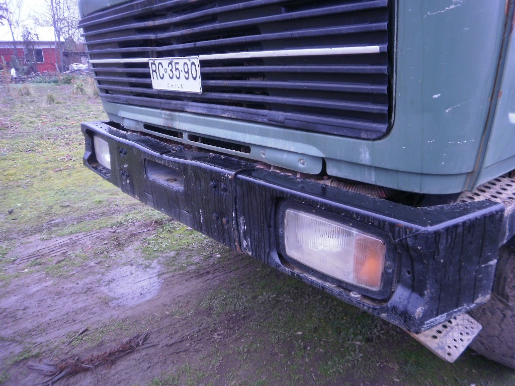

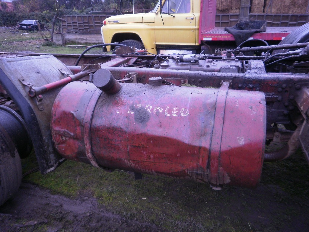

The diesel tank was terribly knocked but it should be replaced anyway for the planned autonomy should be at least of 1200 km.

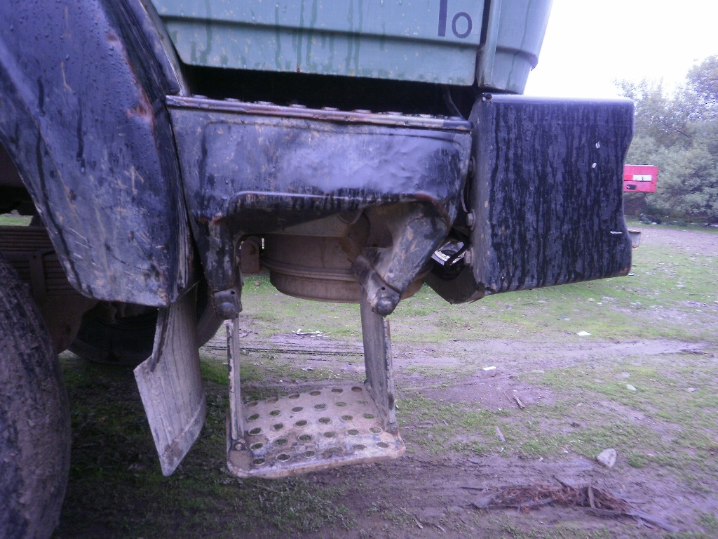

Every periferic component had suffered from the lack of love and hurt by rocks and every object of the road, forests or the mountains it had been working on the past 22 years in Chile. It was imported in 1998, I don’t know how was this possible because it is forbidden to import used cars, at least at present days.

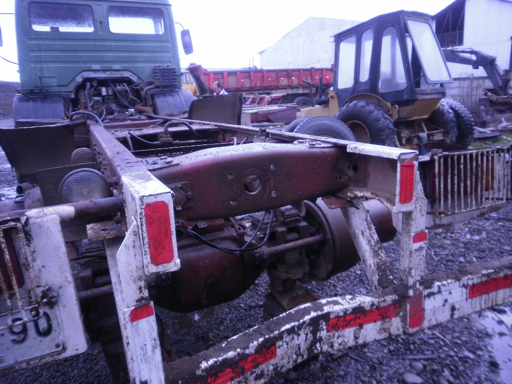

On the other side, the chassis was OK and there was not much rust all around. Someone had welded some pieces of steel to the tail of the chassis but this was not important at all.

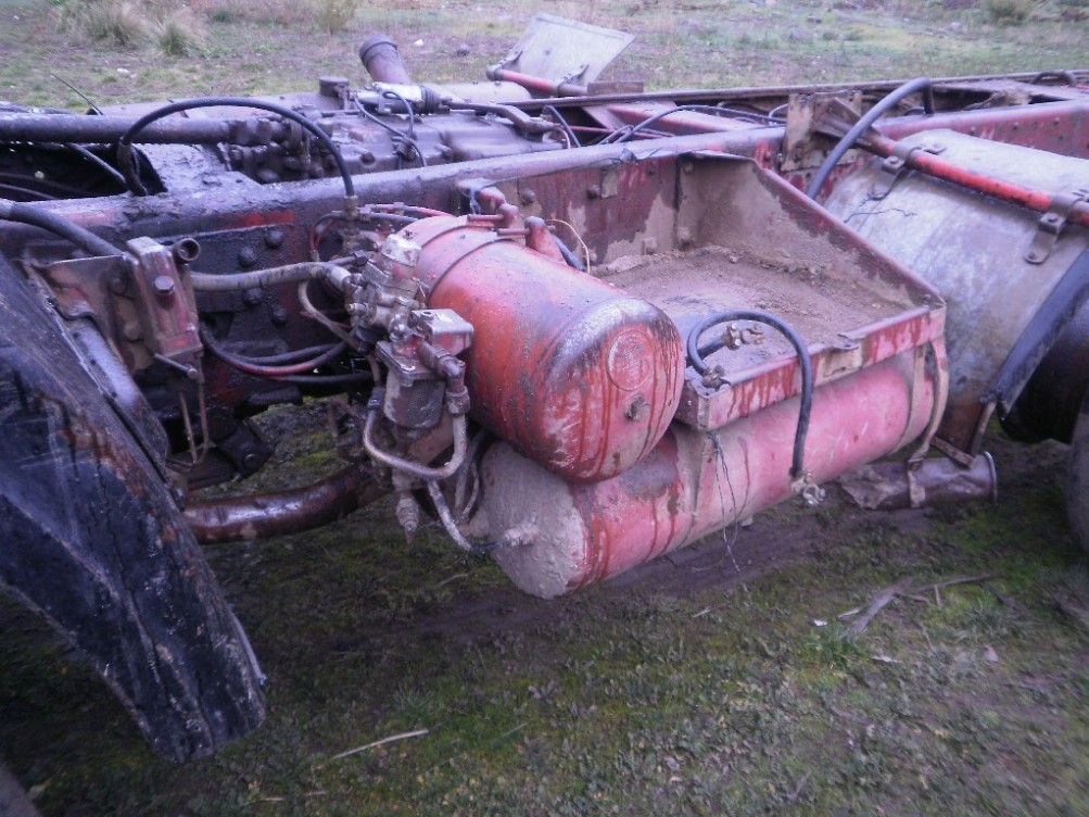

Air tanks and valves looked quite used and it would be necessary to check it all out. The idea was to duplicate the amount of air capacity to back up the pneumatic suspension and the remote wheels inflation system to be installed. The tanks should be placed on the rear part of the chassis, somewheere between it and the box.

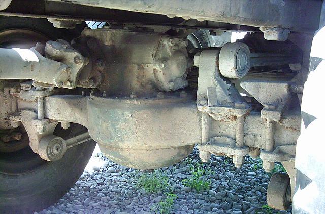

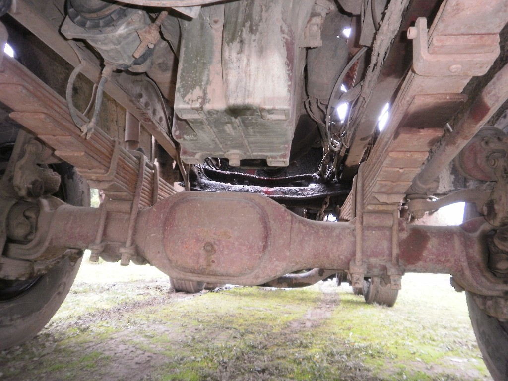

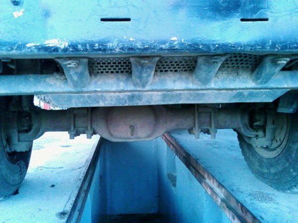

The axles looked healthy and worked properly but some leaked from the cubes.

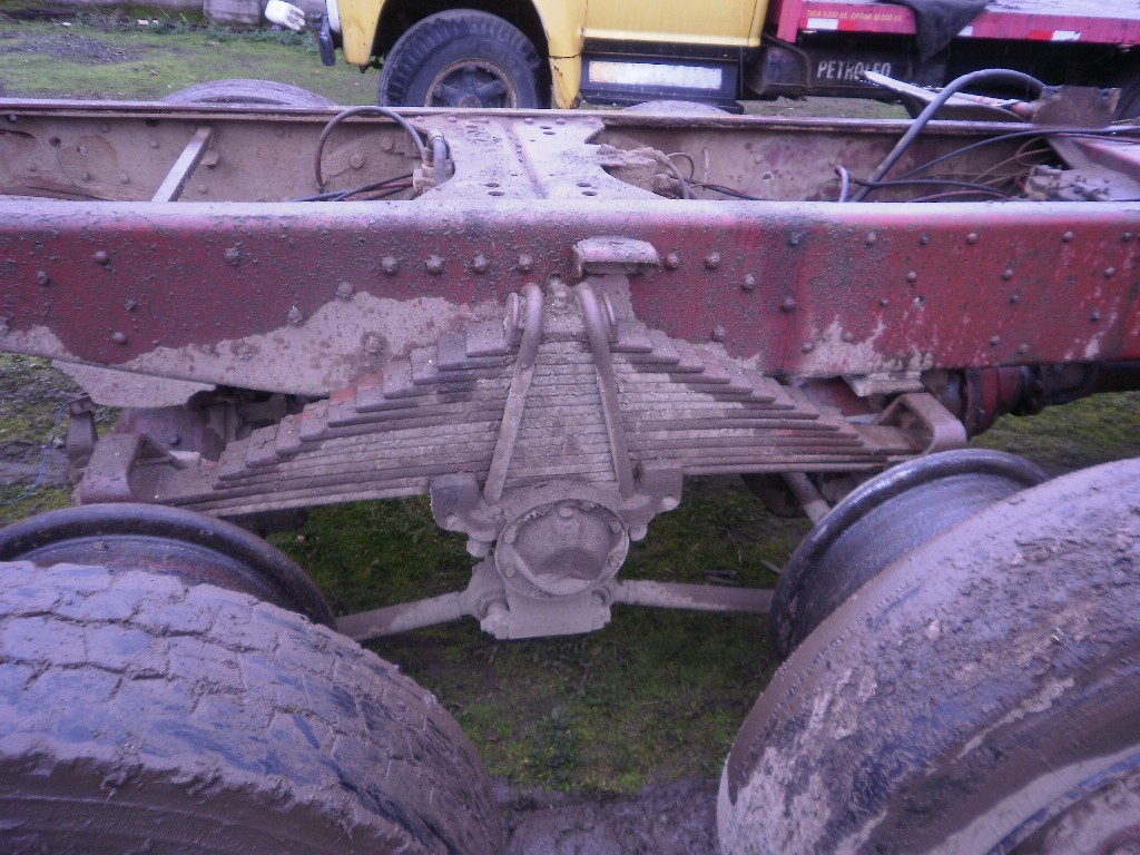

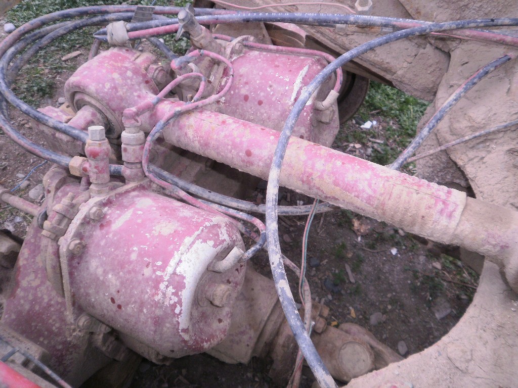

The suspension arms of the tandem had lost the warranty long ago and the silenblocks were almost turn to dust. All the plastics and latex elements of the brake system needed urgent servicing.

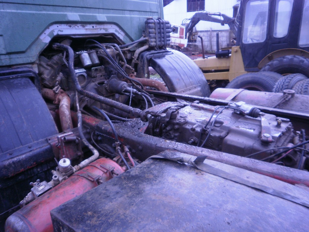

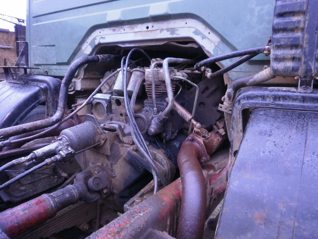

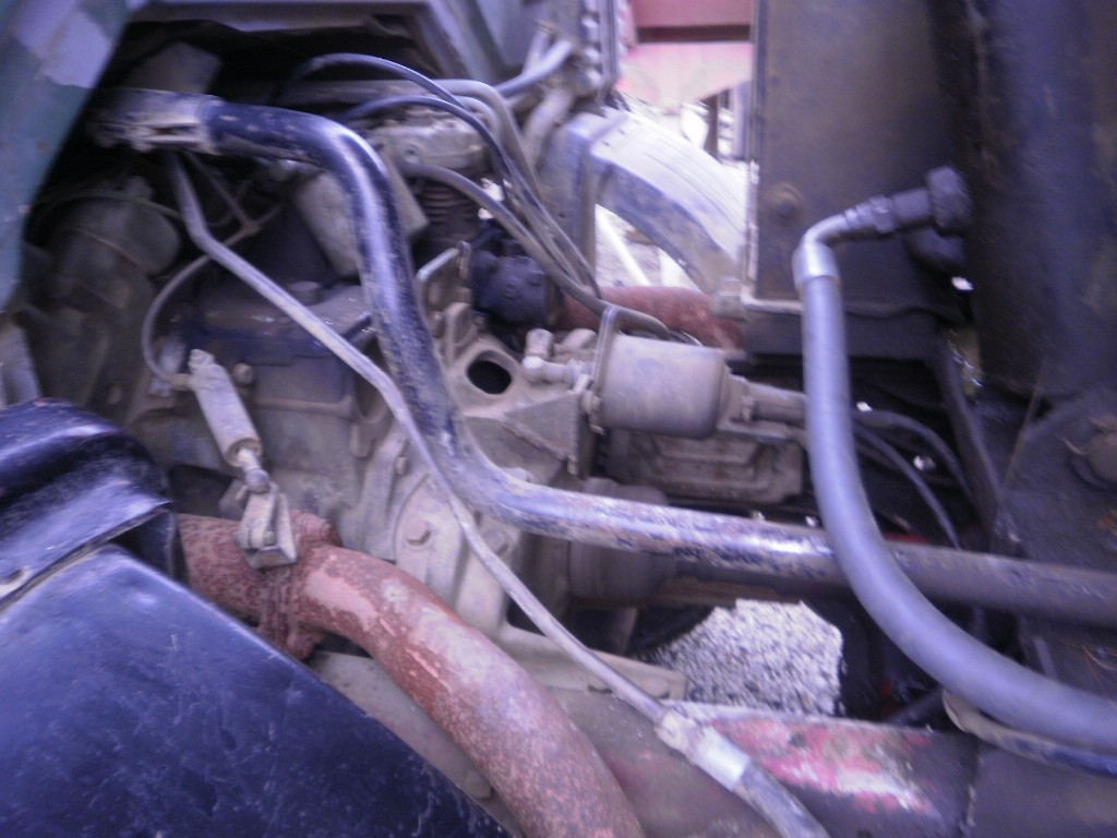

The engine was an OM 402, V8 257 Hp and 12,76 lts., with no turbo. It did the job and get to San Felipe because the Good Lord wanted it and Mercedes did a good job fabricating these things.

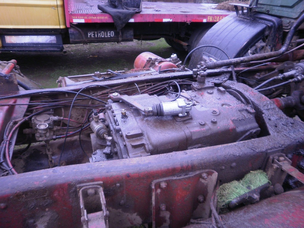

The gear/transfer box was a divorced gigantic one, with eight speeds forward and two aft, with a super-low gear that I hope will take me out of trouble in the near future. The photo shows its massive bulk and the impressive web of tecalan after many years of improvisation.
It takes only one look at the rear tandem to see that with such a suspension neither a box nor your kidneys would stand a cross-country trip, not even a short one.

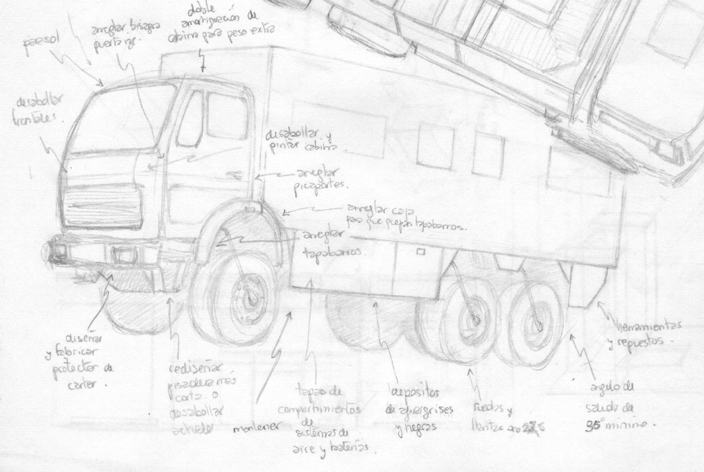

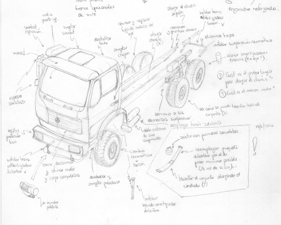

The hurried sketch represents, summarily but incompletely, what this venerable truck needed to be done to transform it into the wanted Merkabah.
The photo shooting took place under a very gentle afternoon rain shower, and I put the Terrano after the truck to start planning about the future trailer for her. Later on Eduardo took the truck for a short mudding essay to check again, and for pure fun, the blockers.

Hi Pairospam,
your idea to increase the volume of compressed air wouldn't be allowed in Germany as far as I know. You are modifying the brake system (essential) part and the time to re-fill the system should be done in a certain time frame. By increasing the volume this time is increased.
NOTE: I have read this in a forum, I am not the expert to say if it is really applicable for Germany. And for your country I definetely don't know it at all!!
In your post from 04.05.2011 is a slugline between two pics missing - therefore we need to scroll to left and right for every longer sentence, not very conveniant. Please try to edit! Thx.

Joe:
Always nice to hear from you.
The brake system itself will not be touched at all; the air filling circuit is secuentially charged, and the primary brake circuit is the one that gets charged first. Once this is accomplished the rest of the tanks begin to get filled at a higher pressure. At present the clutch is air-dependent and it is very boring to be sitting there waiting for it to be ready even when the maxis are loose.
You are absolutely right: scrolling back and forth is not only inconvenient, it is quiet annoying! It was a mistake that I did realize only after submiting the post. Hope not to do that again.
