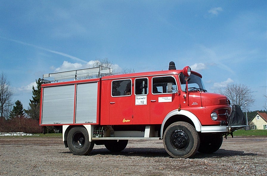

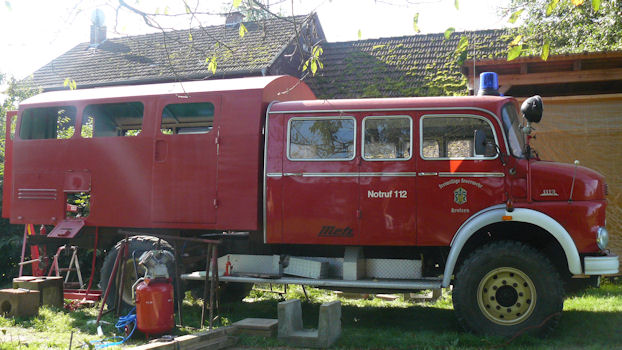

Hello TimberwolfII,
this is a Mercedes-Benz 1113 LWB with crew cab (the small one) and a 4-meter-box:
I would not recommend to have a box that is even longer!
This is what you plan to build up: MB 1113 LWB (small) crew cab with a LAKII (4,30 m long IIRC):
The rear overhang is already considerable! Also the box wil be set up very high on the vehicle frame.
In my opinion, the combination of a 1113 crew cab with a big (longer than 4 meters) camper box is not ideal and will have some drawbacks.

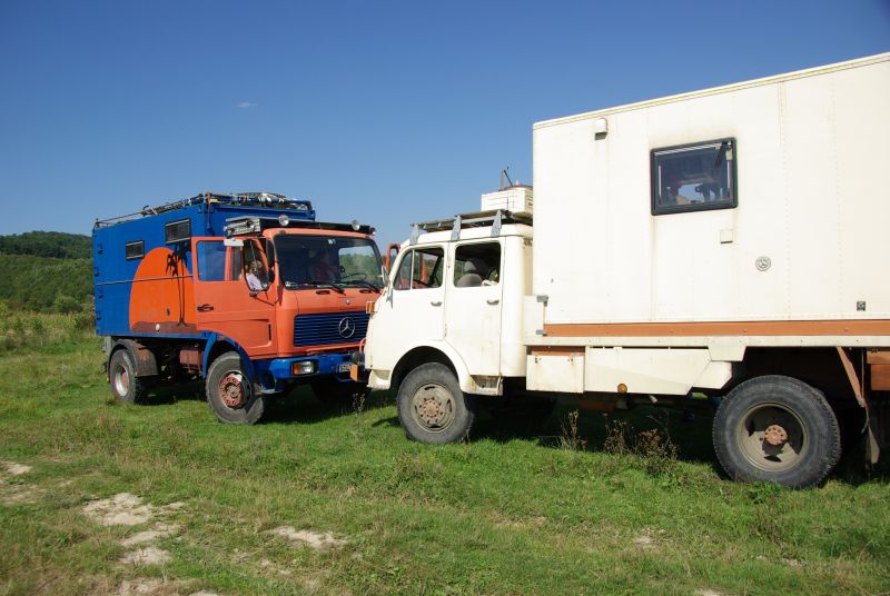

we have a Steyr 680MF and we are Travelling with 5 Persons. Three Kids (aged 10 8 and 4)
Here are some Picture from our Steyr 680 MF (Crewcab)
Compared with the Steyr 680
Compared with an 1617 with Nato Shelter

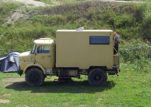

as i´m a very proud mercedes owner (and owner of a very small collection of mercedes-stars which I harvested earlier in my life when i thought I´m somehow political interested...
i recommend the MB 1017 crew cab as postet by landwerk.
i think this working guy will meet all your wishes...including older but working mechanics...if your heart is in oldtimers you should keep the newer MB 1113 in mind...
as i had some deeper "insights" in this car:
5 people?
perfect.
is not for sale, but easy to copy...

Yes, they do! Like ours ...TimberwolfII hat geschrieben:I haven't seen a 1113 with a short doka AND a long wheelbase chassis yet - do they exist?
http://www.allrad-lkw-gemeinschaft.de/p ... php?t=4201
In fact the combination of short crew cab and long wheelbase (4,20 m) is very rare. You will find:
1) LA1113B as a so called GKW (Gerätekraftwagen) from THW
2) LAF1113(B) as a fire engine "Schlauchwagen SW2000" (hose tender with 2000 m of fire hose)
3) LAF1113(B) as a fire engine "Trocken-Tanklöschfahrzeug TroTLF16" (water and powder tender)
No. 1 is no problem to find, there are many of it. Always with a (heavy) winch, but sometimes not in the best condition.

looks like that
No. 2 is hard to find, but a good choice, because there is no water tank, water pump or winch to remove. There are versions with a single cab, too. Last year, I saw 3 or 4 for sale in mobile.de or ebay.de.
this is ours
