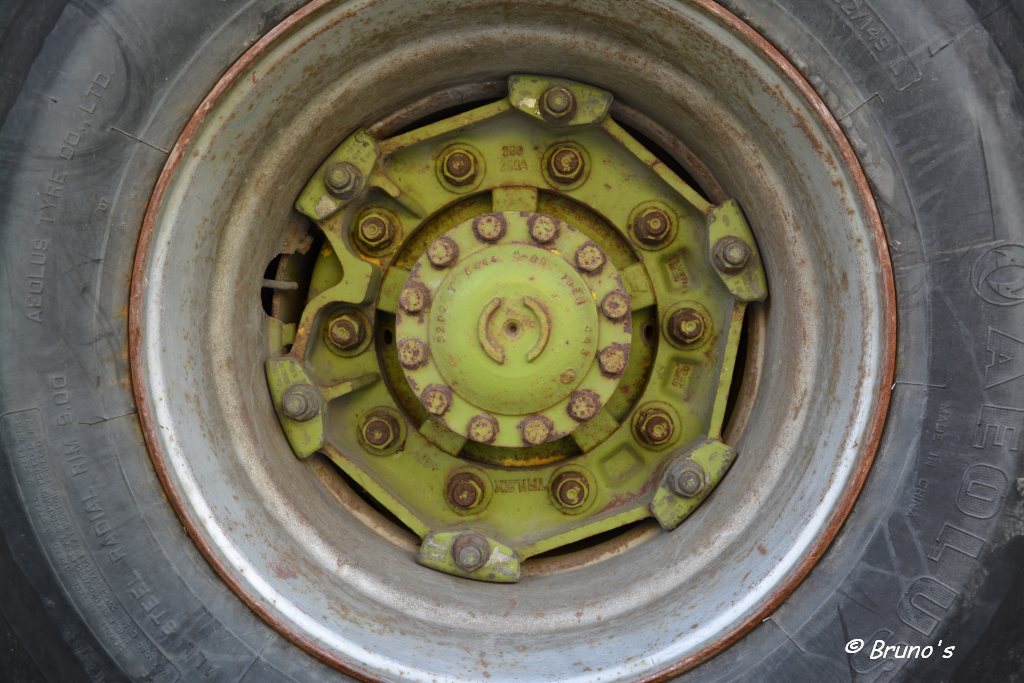

This is a Adapter from rear as example This is the Trilex rear wheel hub You can see that the hub is detached.
And this is the Adapter in Front You see the 10 bolts brake drum with the Adapter.
On page 217 you can see what they look like at Mercedes or MAN or Scania.
Many people don't recognize at first glance whether they are adapters or Trilex axles and some people barely know the system.
Greetz Uwe
Greetz Uwe

Thank you so much for posting those photo. It's definitely got the Trilex Hub on the back. I think it's the adapter on the front though. I didn't take very good photos of the front when i was there.Borsty hat geschrieben: ↑2024-04-03 7:22:27Sorry for the late answer. Unfortunately the numbers don't mean anything to me
Greetz Uwe
Assuming this, what would be the budget to convert rear to standard hubs? I did a lot of reading and it sounds way more complicated that one would expect. Not just changing the hub.

No Problem. So, i think you have a Swiss version with a width of 2.30m. In this case, the handlebar/push rod is also more bent so that the wheels have space at the front. What irritates me about the data card is the code R88 Tublex rims 8.25-22.5, narrow, for 12 R 22.5 sales but not the axle and the adapters.sprocket3 hat geschrieben: ↑2024-04-03 16:06:05
Unfortunately, there is no longer any material available to swap to normal hubs and is very complicated. In addition to the hubs, the brake drums would also have to be replaced, etc. In terms of price, you can almost get a new axle. For single tires the only way is what I had done. Officially with papers and registered to the vehicle. A rim without a tire instead of a twin wheel is rubbish. In a pinch, yes, but not for a longer trip.
