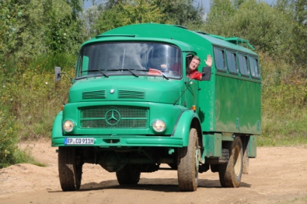

Although these are my personal basics I have ovened 4 RV´s since 1975 (all 2 x 4 and 4 x 6), "I did it" 4 month ago and bought myself a 4 x 4 - 30 year old Mercedes 911 from the German police equipped with a windowed cabin (~ 4m x 2,30 m and a hight of 1,78 m in the middle) that contained most of the basics needed for an RV. I`ve investigated ~ 2 years to find the "right one".
My 2 boys are out of the house already and my wife is not too keen on this car (yet).
My story and the details how I bought it, including a lot of pictures you can find here.
http://www.allrad-lkw-gemeinschaft.de/p ... hp?t=22121

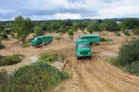

Last weeend I`ve taken it to the Saverne meeting - they have a big 4 x 4 terrain there, where one can "check the cars on their abilities" - I can only say that this old car can do much more then I will ever face on a road thorughout this world where i will be travelling. I was born and raised in Latin America and I know what bad roads can look like.
Keep these basics in mind when you choose your car, if you want to be happy with it long term.
Cheers,
Udo (DL 8 WP)
This is my little toy ...
