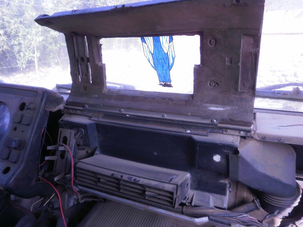

When I had the time, I commited with the servicing of the heating. As the fans of the AC would take over it was not necessary to keep the old and deteriorated fan of the original heating of the truck. I disassembled firstly the heating of Spare to see how it was made and to get eventual useful spares. There was a lot of leaves and stuff and even a mouse nest inside the box, and the radiator was almost blocked with dust. The heating from the Merkabah was in better shape but the valve for the hot water was fiercely stuck.
I removed the fan and its motor and cleaned it all the best I could. I finally disassembled the hot water valve of Spare’s heating and found out that rust was the only reason for it to be stuck too so I repeated the procedure and disassembled the one from the Merkabah, cleaned and lubricated it. Reassembling what is not supposed to be disassembled was not easy and I hoped that it would not leak once in its place. Just crossed fingers.

I have a question regarding the hot water valve.
Mine is not closing 100%. That means I would have always a lottle bit heating - even if I turned the "heatercontrol" to off.
To avoid that I made a "quick and dirty" solution. I installed an additional shut off valve in the engine compartment - so that I can completely close the flow to the cab heater during summer days.
Now my question:
What do you estimate: How much work is it to dissasemble the hot water valve from the cab heater device?
For sure I will have to drain a little bit coolant - not an issue.
But the rest??? Do I need to dissasamble the half of the dashboard?
Now my question:

Dear Frank_404s:
Mine is always bigger than yours... he, he. But, seriously, it is very difficult to weight what the expression "too much work" might mean to anyone.
To clean the valve - this is, in final terms, what you have to do- you must take the heating out, and to do that the Mercedes guys have thought to put it as easy as possible to you.
Disconnect the hoses from the front and do not mind too much because you will loose only a few cubic centimeters of coolant, then remove the front panels of the middle of the dashboard to expose the heating pretty straightforward. Don't have to deal with wiring. Remove the heating box unplugging first the three or four wires that go from the controls to it and you will access the control valve.
The valve is sealed and you have to remove the metallic cap very carefully unbending the edges that hold it to the plastic body. Do not try to force the mechanism before disassembling it. Once you clean all the garbage you, even more carefully, have to bend again the edges of the cap so it all fit again. Apply gelly vaseline to the rubber components inside the valve at reassembling and make sure it all moves smoothly.
Of course, you will find probably a lot of dust inside the box and it will be a good occasion for powerblowing and washing the radiator.
Hope you have fun.

Hallo Pairoa,
THANKS a lot for this infos.
Seems not to be toooo difficult!

When I could, I finished the cleaning of the heating and replaced the worn out foam strips, then wrapped the whole thing and left it on any available surface to wait for installation.
Little things, one at a time, like the cleaning of the bolts and nuts of the hinges of the cabin. They would be reused for the springed hinges of Spare. After a couple of hours I had to leave, again.

During the week I collected, when I could, more pieces which were near for use, like the blocks for the springs leaves of the front suspension of the cabin. Had no idea of their last location though I found them, as usual, in the last box of the pile covered by the thickest layer of dust and dog hair. I also prepared the rest of the pieces of the rear suspension and locking system of the cabin for the washpriming and the priming.
The whole week passed and these little tasks were the only I could accomplish. Another Saturday arrived and Edie was the most interested in finishing with the paint issue for good, but the weather was not with us, it was pretty cold and the humidity was very high. The forecast menaced with rain at midday and so the future was trully dark.
Before anything I finished the sealing of the rear windows with Sikaflex 221 while Edie prepared his own business. We then began to sand the cabin with a very fine sand paper to smooth the primer and take out all the impurities and crap that stuck on it during the drying process that, in the actual conditions of the shop, were more than I wanted.
Sanding very carefully not to take the primer out, especially on the edges, we covered the whole surface inside and out. Of course Edie worked in as he, if he wanted, could easily stand in it.
Near midday the air warmed up a little so we dared to paint the inside aspect of the cabin where the finish was not a critical consideration. Edie covered even his eyes and got to it. There was a little tension in the air as we both were worried about what we were doing. Was it too cold, or too much moisty?
As the little big Ecuadorian painter proceeded with the spraying of the paint the tension relaxed, and the fact of seeing how the sandy color covered the interior of the cabin with its carachteristic glow brang a less serious mood to the job. When he finished I went on from the outside painting the angles and corners he could not reach the inside. The paint looked pretty good even if it had that little pinkish tone that eventually would subside with time.
The sun finally showed up through the cloudy skies and we profited to expose the cabin to its rays to let the metal warm up and so enhance the conditions for the paint to dry up.
In the meantime I took the paintgun and sprayed the prepared pieces with washprimer while Edie amused himself finishing some details on the roof that he had struggled so hard with to prepare.
Re: Mercedes 2626 AK 6x6
Spark, on his side, limited himself to sunbathing and observed our efforts with not too much interest. The chassis of the Merkabah, half finished, half covered, half wedged, accompanied him in silence, waiting for the supermegaterribleearthquake that finally never came.
The obstinated sun finally won and kept on shining up there so the paint was hard and dry quicker than predicted. Encouraged by these unexpected events Edie went in the cabin again and, stepping on a log, he gave a first hand of paint to the roof sticking out through the hatch hole. Then, following the precise instructions of the senior painter, I painted the sides, the front and the back.
With only one hand the cabin looked already spectacular to my eyes. Finally! It was an actual event, and Eduardo and Jaime, the guy next door, joined us as spectators, encouragers and critics.
After a while, and a little more paint, we gave the cabin a second hand following the same pattern, making great attention to the details this time. Initially, the front middle aspect that would remain behind the front grille would be only painted in black, but as there was enough prepared I covered it all with a couple of hands of finition paint too. I still had to drill a couple of hole for the AC hoses so the black paint would be the last to be applied to protect it all once finished.
When exposed to plain late sunrays the paint looked pretty brownish but in the light shadow the camera sensor is less tricky and the color looks more real. I was not in the mood of manipulating and editing the pictures so I uploaded them like they were. The cabin looked pretty good, no matter what.
