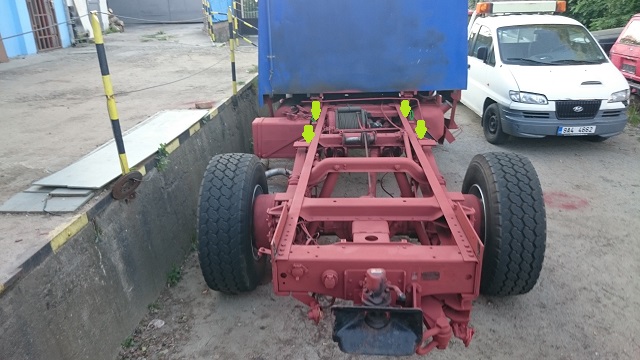

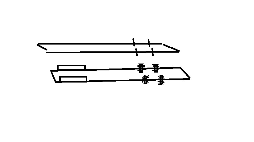

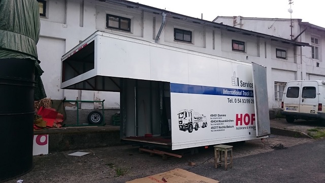

Hallo, I have a ex THW 1113. I want to change a box for another one,, there is 4 point fixing for screw with spring , the screw is just on cabine side of sasi. is it ok for biger box? question is, is it enough this four fix points ?

#6 Beitrag von Freddy » 2015-06-19 10:36:32
Do you have a solid frame under the box?
keep in mind that the truck frame twist enormously when the vehicle is articulating.
So the box will need a solid that protects it from breaking apart.
Further you must give the box the option to get back into its intendet position after it has raised from ther vehicle frame (I think i see some steelplates at the end of the truck for this)
To figure out if the four fixing points of you're "Federlagerung" is enough you must look in the "Aufbaurichtlinien" from Mercedes Benz.
Of course you must thing about the lenth of you're srings, diameter and strngth of bolts etc.
Keep in mind the "Federlagerung" is a way of fixing the box without tightening the screws, their only job is tho keep the box from sliding.
