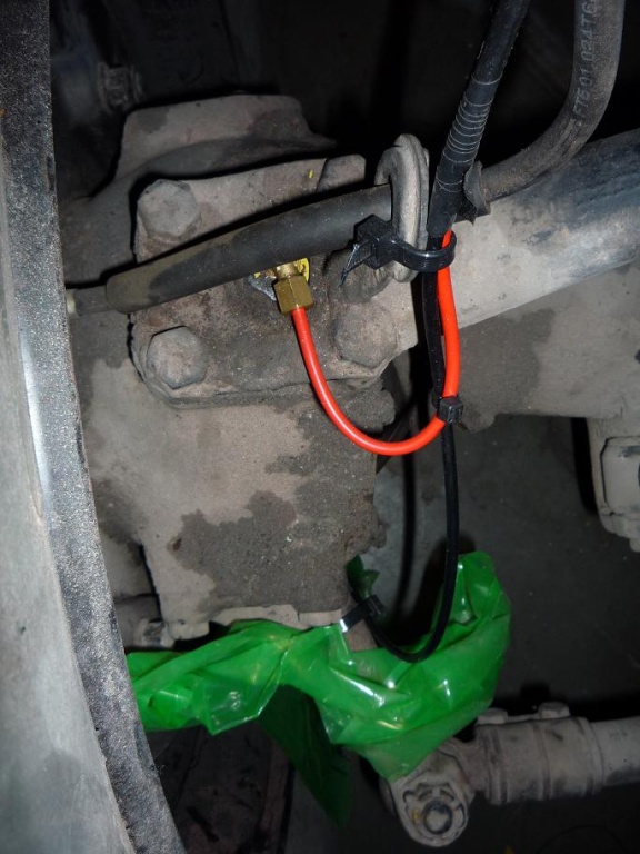

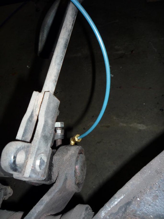

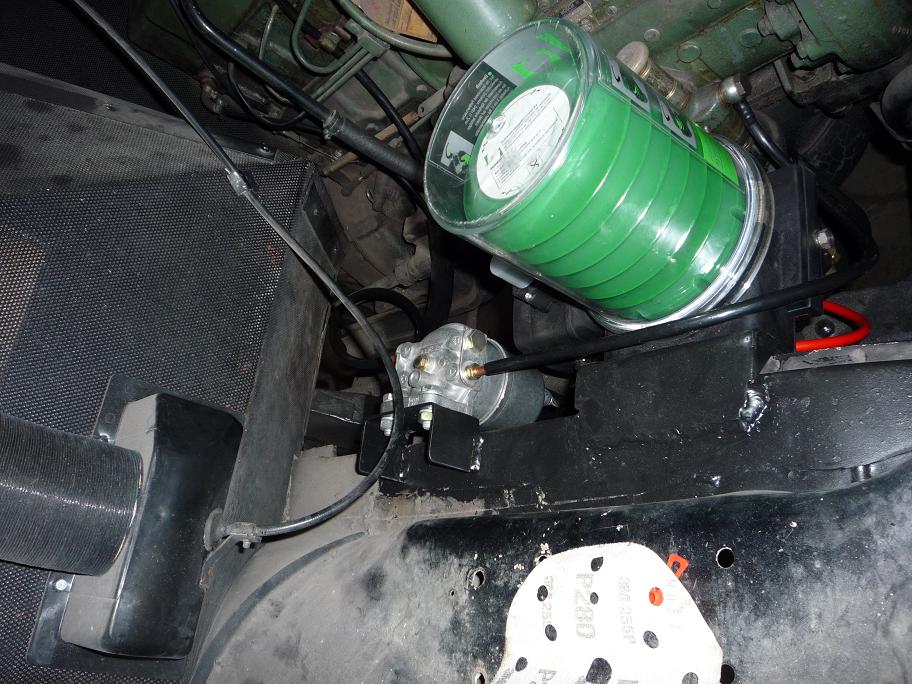

Tim hat geschrieben:The central-lubrification-system is build in by my girlfriend.
o.k. this is one of the posts that grow into a "must-read" for my wife...
i´ll send you my e-mail adress so you /or your girlfriend can transfer a bit of know-how/ photos of the system
i´m quite lazy and hate lubricating my truck...so i´m very interested in that greasy solution.

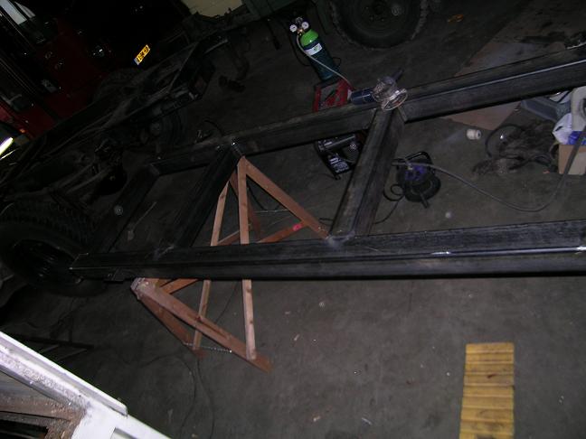

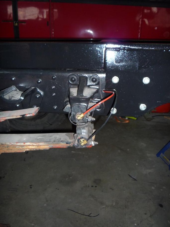

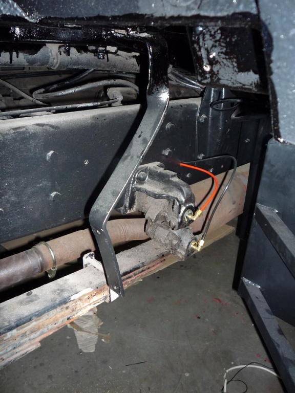

another question...in this post

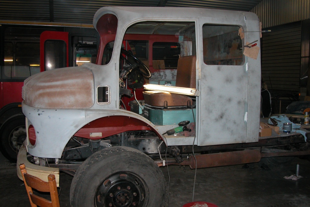

(Verfasst am: 2009-08-02 22:35:07 ) the first pic.
it shows the backside of your cabin/ the suspension of it.
the welding... whats was the reason for that.
to get the cabin higher to have more space in the wheel housing ?
you use only the rubber buffer as suspension?
it might be useful to think about the twisting of the trucks frame.
this joint cabin >rubber< frame could cause problems because of twisting...
it might be better to use a loose connection (vertical) that allows the cabin to travel a bit...using springs for example...
