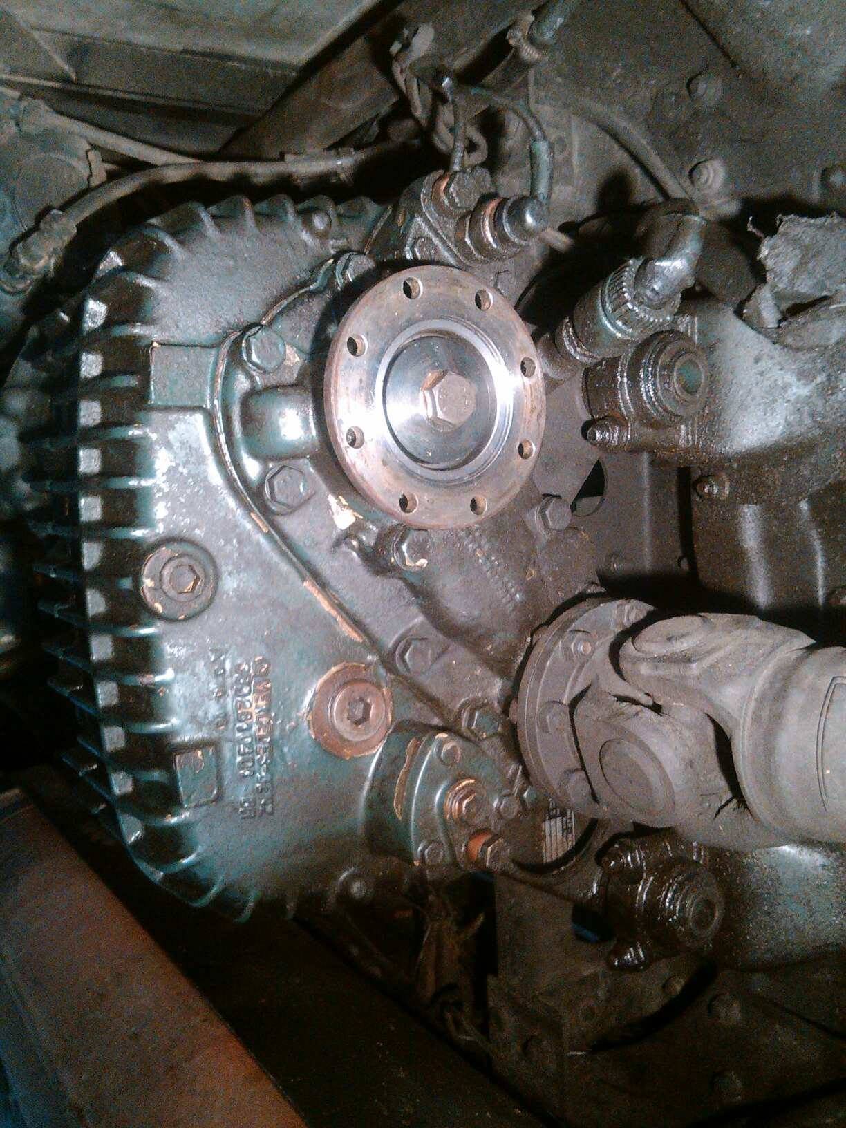

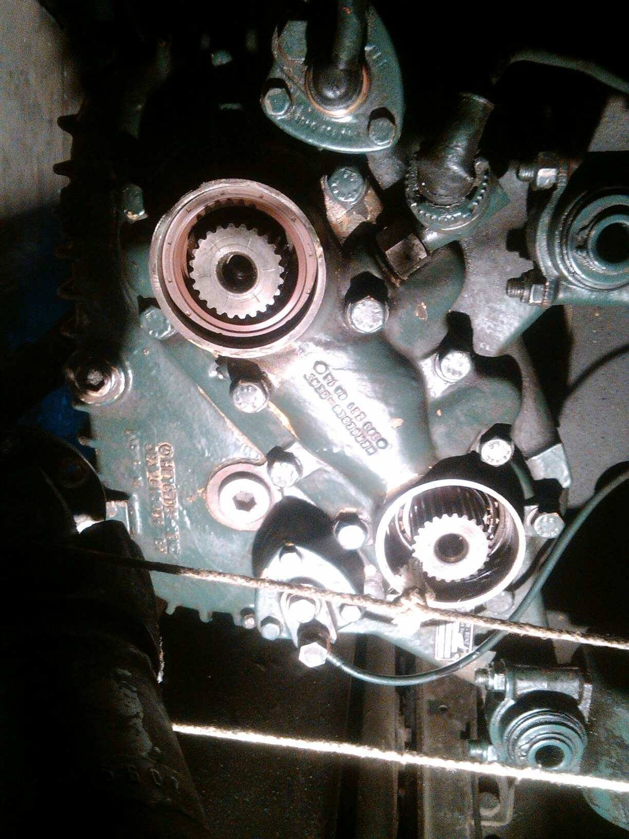

Hello,
My VG500 transfer case is dripping oil from the front transmission seals.
I want to replace them but first i must take both flange out, and the cover.
Anyone knows how to take out the nuts (24) from the flanges? And to put them back how much is the force applied.
What is the best way to block the flange? I tried with a metal pin trough the screw hole and broke the pin.
Thanks in advance

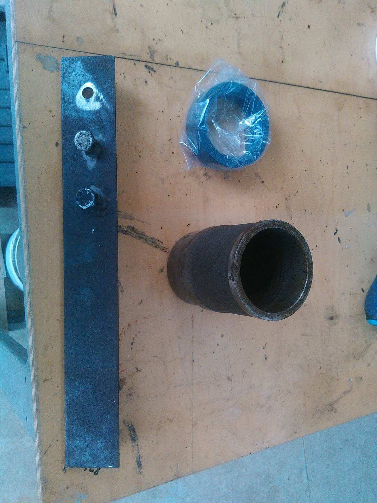

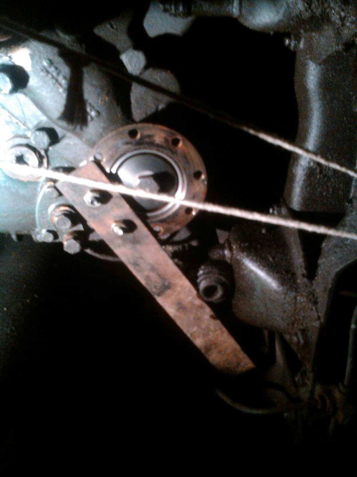

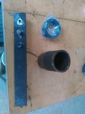

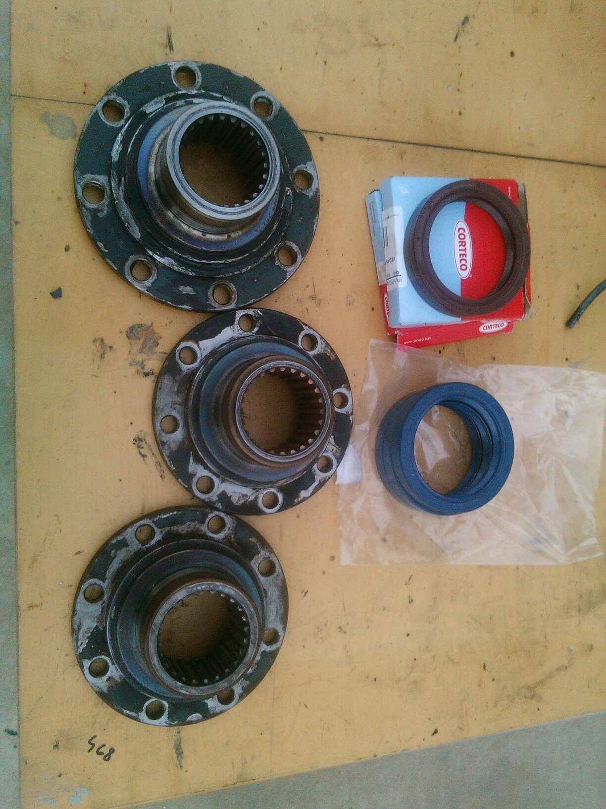

Re: Transfer case VG500 oil dripping
Hello,
Thanks DePo for the nice idea...i made a steel plate with 2 holes and worked perfectly.
Used the round tube to fit the seals 65/85/15,5 inside and now is good again!
Greetings from Portugal
jenga
jenga
