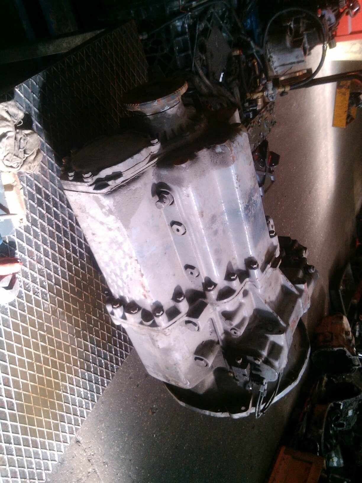

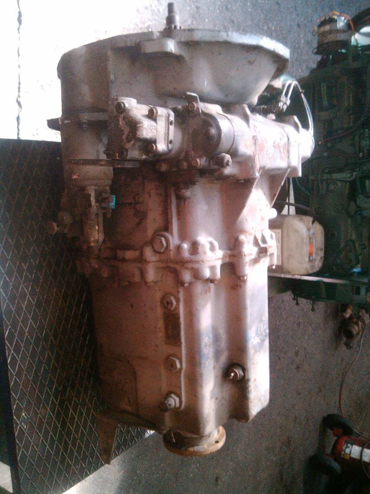

i am the owner of a MB1017AF from 1987 and also i would like to install a gearbox with overdrive and different relation between gears.
I google translate all the topics i find in the forum related to this subject, but because i cannot do the search in Deutsche, maybe there is information that i am missing.
What i understand is that:
The only way to do it is to put a ZF 6/36+GV36. I read many times Walter topic and the solution is there.
What i don´t understand is why the MB GV4 65/6-9.0 cannot be installed?
The google translate is not the best and some times i don´t understand.
I have the OM352A (engine number 353.972xxx) with the gearbox G3.
This engine has the holes for the flywheel housing (Schwungradgehäuse) A352 251 2601 replaced for A366 013 1610.
Today i found this OM366LA from first generation and it has the flywheel housing that fits on mine.
Also had the coupling plate (Kupplung) GMF350X
Also they have a GV4 without identification plate, that came from a OM366LA.
The Truck breakers say is the GV4 65/6-9.0 and it will fit the Flywheel housing A3522512601 that is mounted on the OM366LA engine.
This GV4 has the Flange (Flansch) 150mm with 4 holes and mine is 130mm with 8 holes. I must cut the kardanwelle and change the Flansch.
Also they (truck breakers) have the PTO to attach on the GV4. The PTO has 100mm flange with 6 holes and mine also.
I must change the hydraulic system of clutch pedal to a pneumatic one.
I must build some support for the back of gearbox.
With all this parts will i be able to install the Gv4 on my truck??
Where i will get stuck??
Maybe the kardanwelle, (because the gearbox is bigger) will have another angle of attack..will i get stuck there? What is the maximum angle possible from gearbox to transfer-case?
Will my Transfer-case (Verteilergetriebe VG500-3W) handle the torque of the GV4?

ich bin der besitzer eines MB1017AF von 1987 und ich möchte auch ein getriebe mit overdrive und verschiedene relation zwischen gängen installieren.
Ich google übersetze alle Themen, die ich im Forum zu diesem Thema finde, aber weil ich die Suche in Deutsche nicht tun kann, gibt es vielleicht Informationen, die ich vermisse.
Was ich verstehe ist, dass:
Der einzige Weg, dies zu tun, ist ein ZF 6/36 + GV36. Ich habe oft Walter Thema gelesen und die Lösung ist da.
Was ich nicht verstehe ist, warum der MB GV4 65 / 6-9.0 nicht installiert werden kann?
Der Google Übersetzer ist nicht der beste und manchmal verstehe ich nicht.
Ich habe den OM352A (Motornummer 353.972xxx) mit dem Getriebe G3.
[Anhang = 10] 43878751_575689119534464_4722568957179985920_n.jpg [/ Anhang]
Dieser Motor hat die Bohrungen für das Schwungradgehäuse (Schwundgrandgehäuse) A352 251 2601 für A366 013 1610 ersetzt.

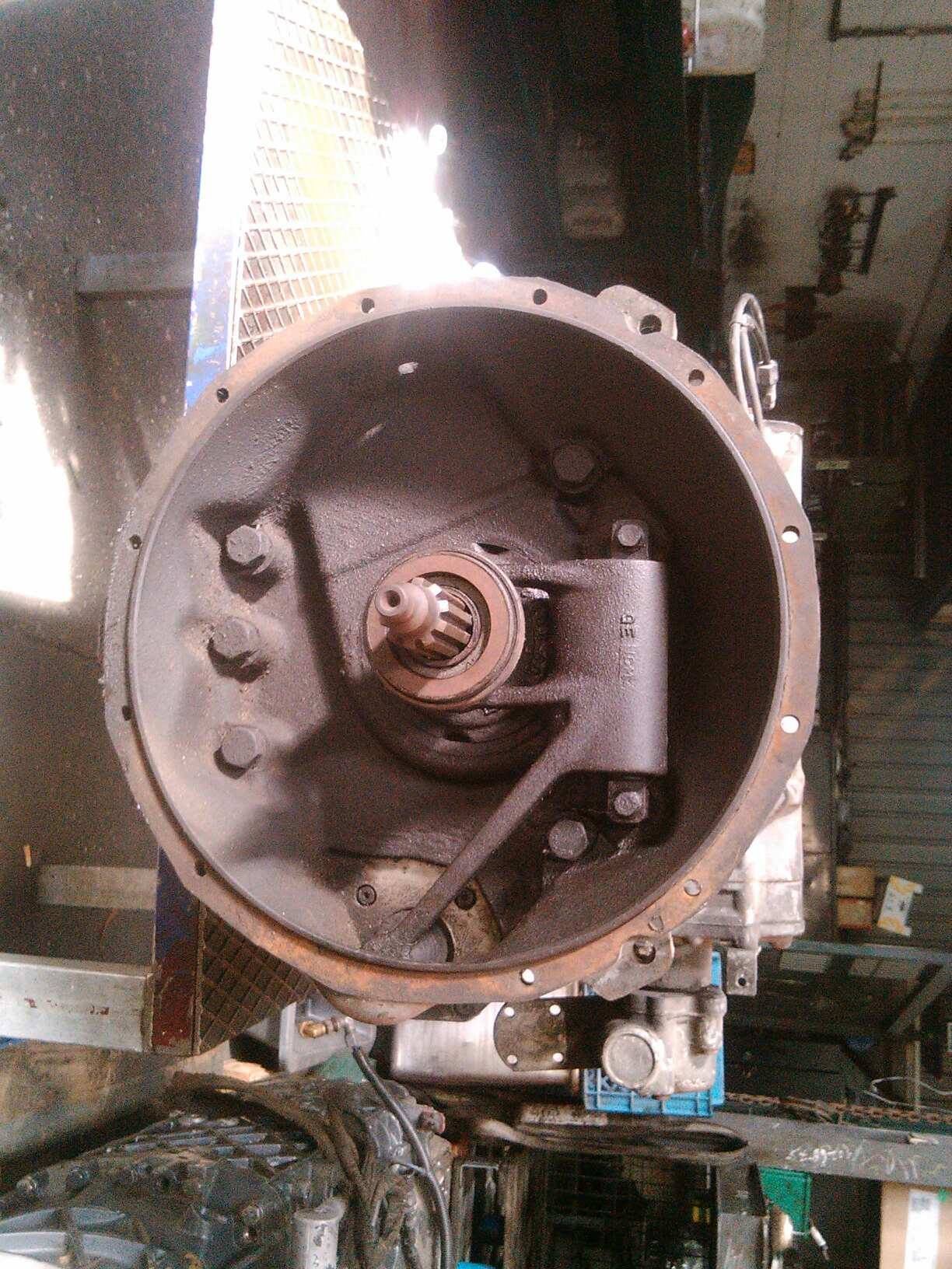

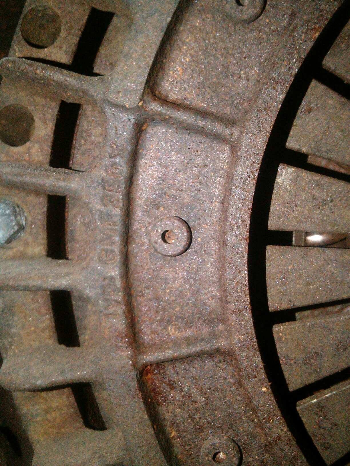

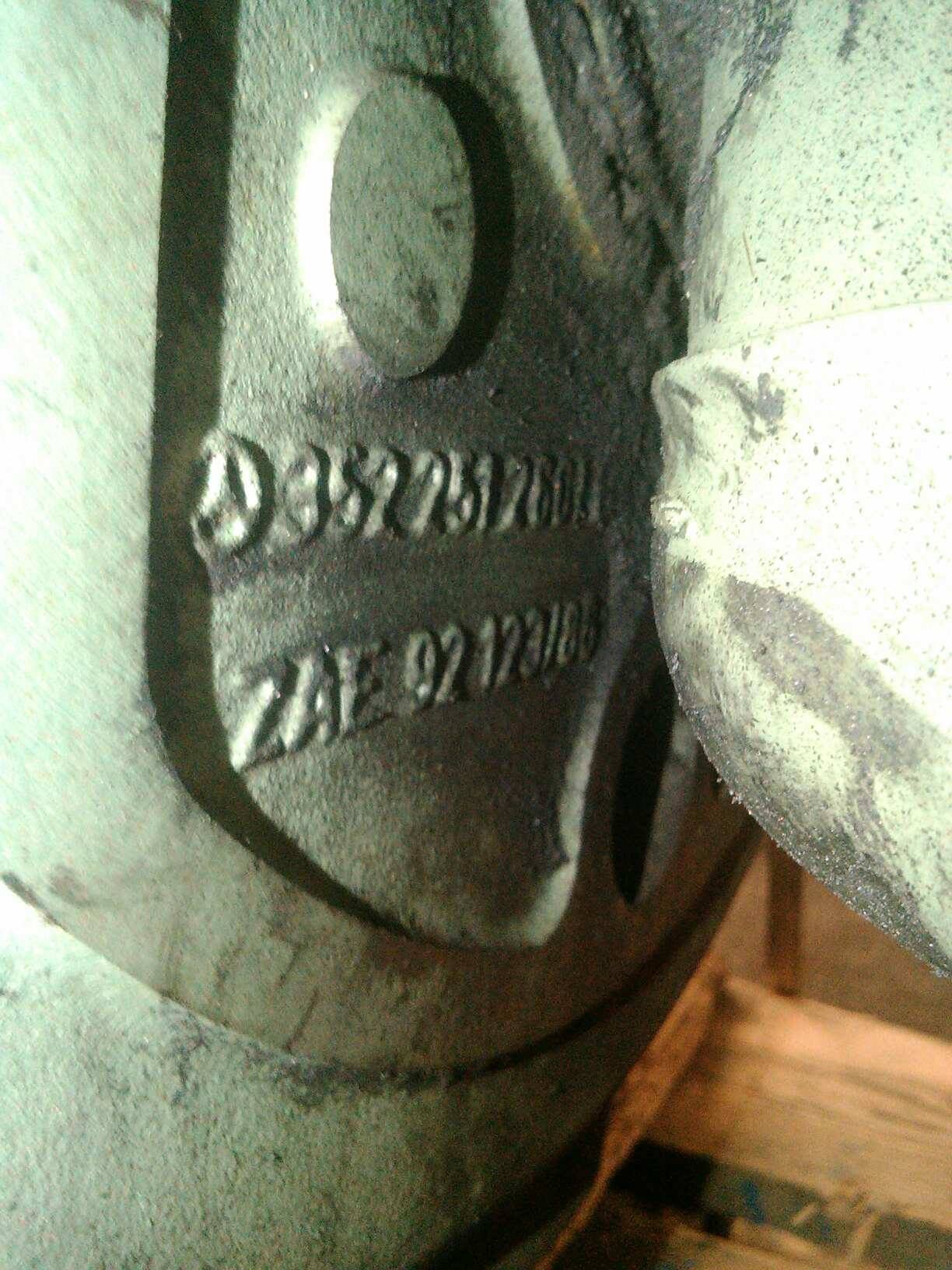

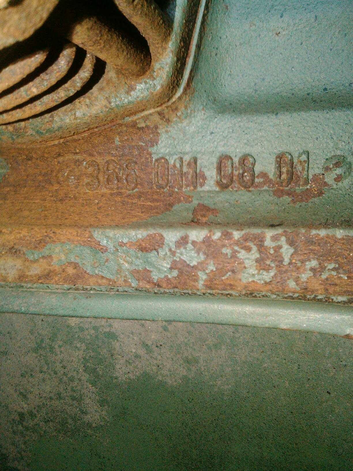

Heute habe ich diesen OM366LA von der ersten Generation gefunden und er hat das Schwungradgehäuse, das zu meinem passt.
[Anhang = 9] 44613912_2282656711976683_7421236766276845568_n.jpg [/ Anhang] [Anhang = 8] 44617833_715894692107795_4457614301590454272_n.jpg [/ Anhang] [Anhang = 7] 44710526_1110327969146954_3158749614991998976_n.jpg [/ Anhang]
Hatte auch die Kupplungsplatte GMF350X
[attachment = 6] 44173737_157436541872429_1877441543518814208_n.jpg [/ Anhang]

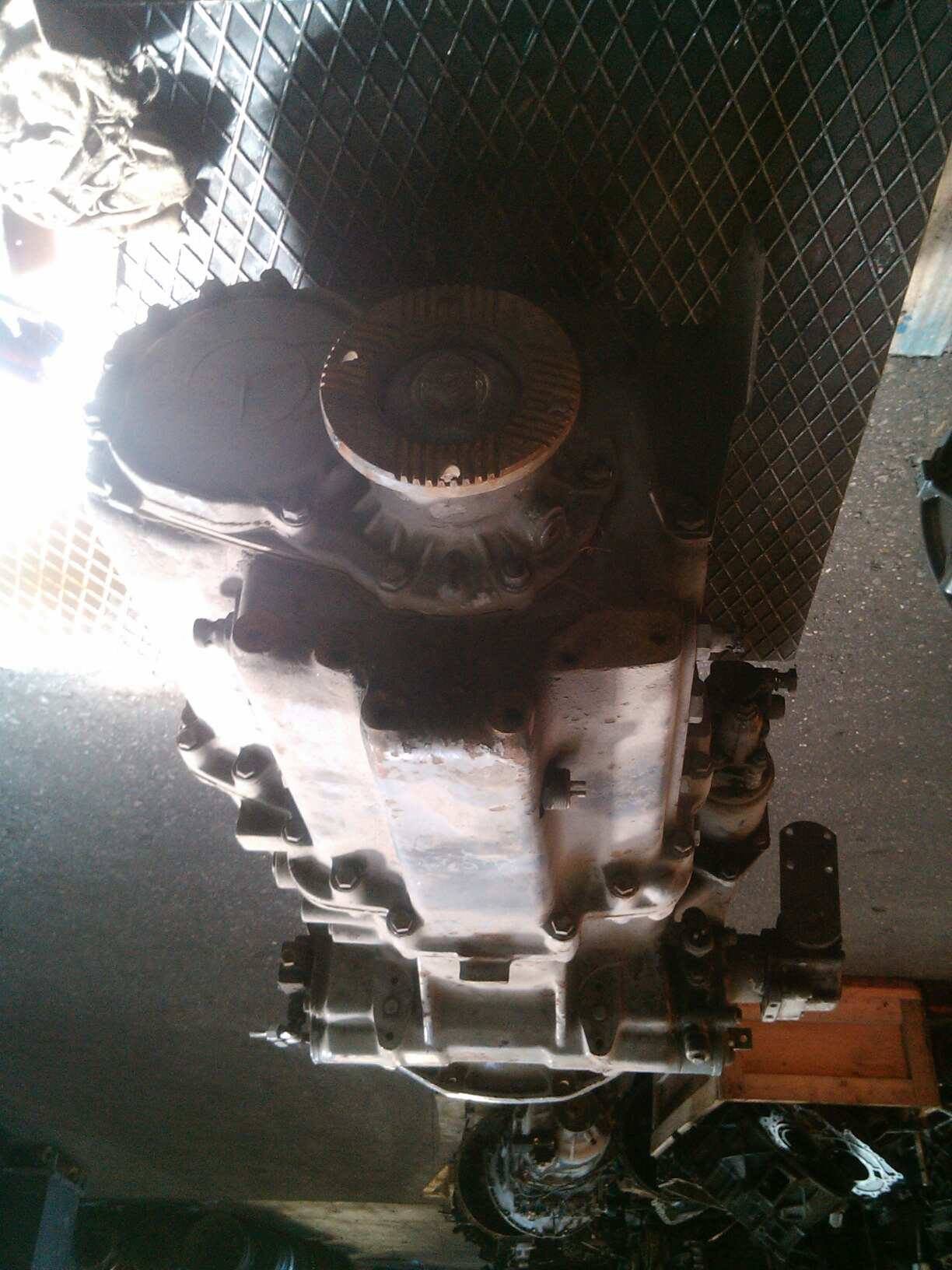

Außerdem haben sie eine GV4 ohne Typenschild, die von einem OM366LA stammt.
Die Truck Breakers sagen, ist die GV4 65 / 6-9.0 und es wird das Schwungrad Gehäuse A3522512601, die auf dem OM366LA Motor montiert ist passen.
[Anhang = 5] 44514605_1608015212633709_4861543425884815360_n.jpg [/ Anhang]
[Anhang = 4] 44571381_318782542280994_6515185231610249216_n.jpg [/ Anhang]
[Anhang = 3] 44585423_790732877938322_6891114785497153536_n.jpg [/ Anhang] [Anhang = 2] 44729752_907070849503789_1275151579451752448_n.jpg [/ Anhang]
[attachment = 1] 44738567_175327556735545_39608450396717056_n.jpg [/ Anhang]
Dieser GV4 hat den Flansch (Flansch) 150mm mit 4 Löchern und meins ist 130mm mit 8 Löchern. Ich muss die Kardanwelle schneiden und den Flansch wechseln.
[attachment = 0] 44546758_325632104692733_1009932731833909248_n.jpg [/ Anhang]
Auch sie (LKW-Brecher) haben die Zapfwelle an der GV4 zu befestigen. Die Zapfwelle hat 100mm Flansch mit 6 Löchern und meins auch.
Ich muss das hydraulische System des Kupplungspedals zu einem pneumatischen ändern.
Ich muss etwas Unterstützung für die Rückseite des Getriebes bauen.
Mit all diesen Teilen kann ich den Gv4 auf meinem LKW installieren?
Wo werde ich stecken bleiben ??
Vielleicht wird die Kardanwelle (weil das Getriebe größer ist) einen anderen Anstellwinkel haben ... werde ich dort stecken bleiben? Wie groß ist der maximal mögliche Winkel vom Getriebe zum Verteilergetriebe?
Wird mein Verteilergetriebe (Verteilergetriebe VG500-3W) das Drehmoment des GV4 übernehmen?
Schöne Grüße

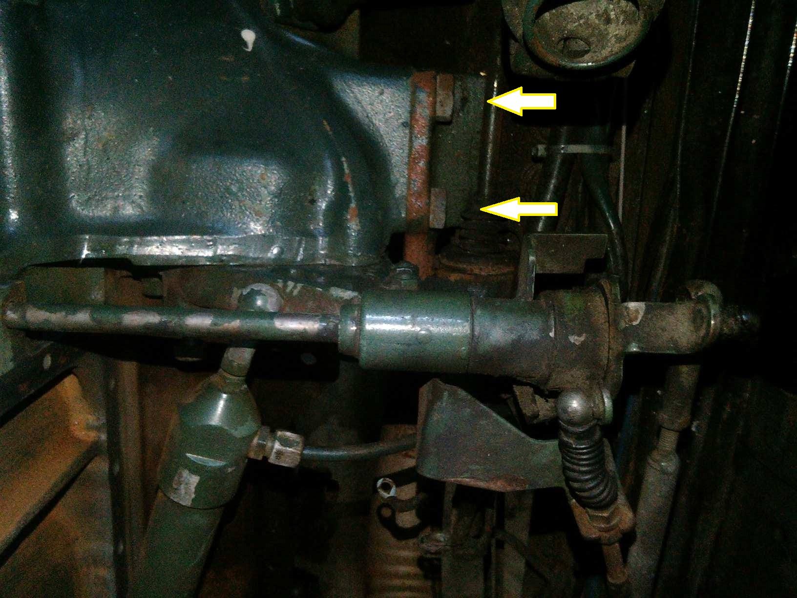

as the gearbox is mounted with only four screwes the GV4/655 is much (!!) to heavy.
Best regards,
Walter

Yes, but my engine has the 2 holes on the top . This 2 holes on the top are the same as on the OM366. My engine block is 366 and the holes look the same.
But even with the 2 holes would be better to build a support?
I can get this gearbox with the clutch kit, flywheel, and PTO for 1500€. The flywheel housing for them to take from the engine they want 500€ but i think i can find for less. They ask this price because they don´t want to take it out.
I am trying to find the cheapest and best solution.

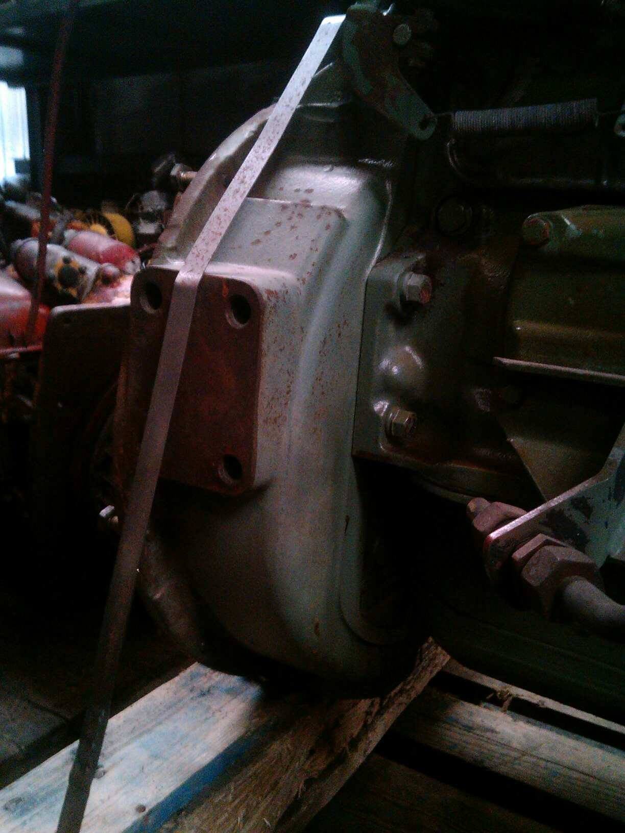

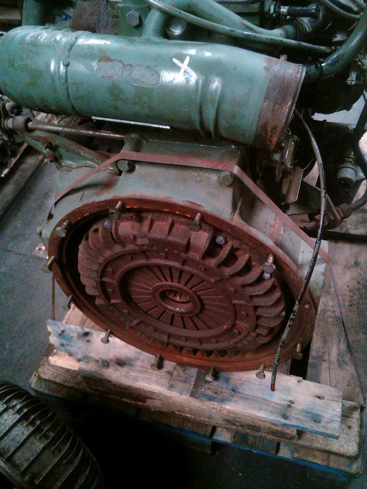

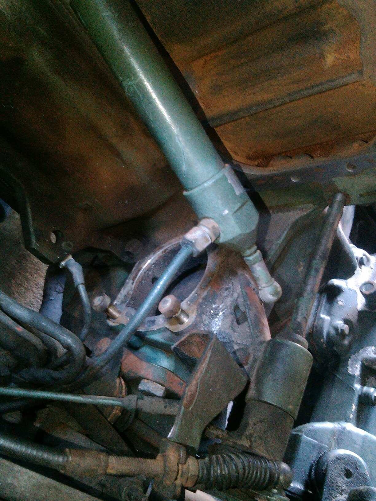

The flywheel housing/flywheel/disk/coupling plate/GV4 will fit my engine.
My worries are:

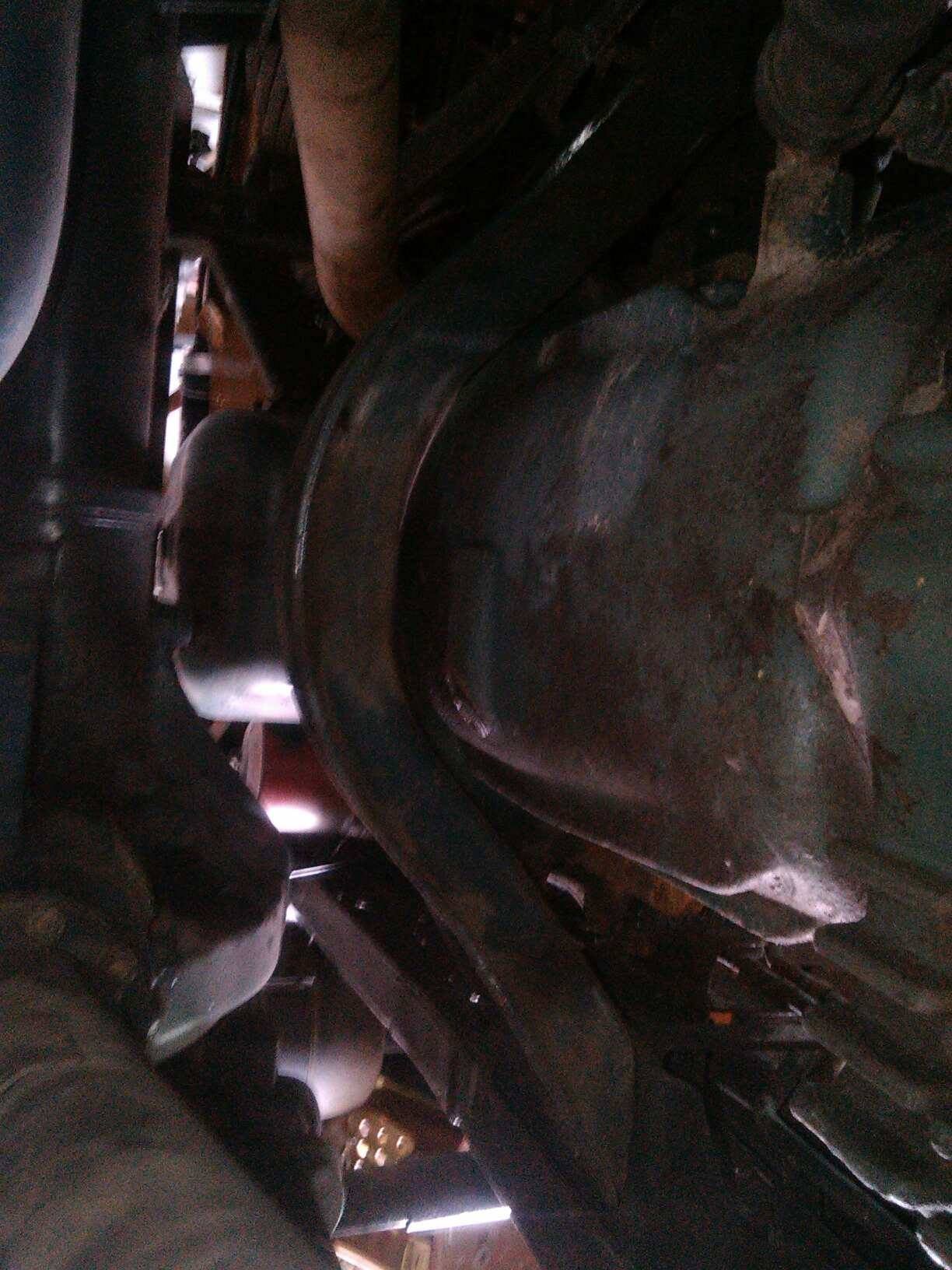

On the 1017AF the Crossbeam is under the gearbox.
Didn't test but i think this crossbeam will not fit with the GV4.
Itchyfeet truck MB 1222AF (https://www.allrad-lkw-gemeinschaft.de ... 6e919d588) has a bigger and lower crossbeam and maybe this will fit! Anyone knows the reference number of this part?

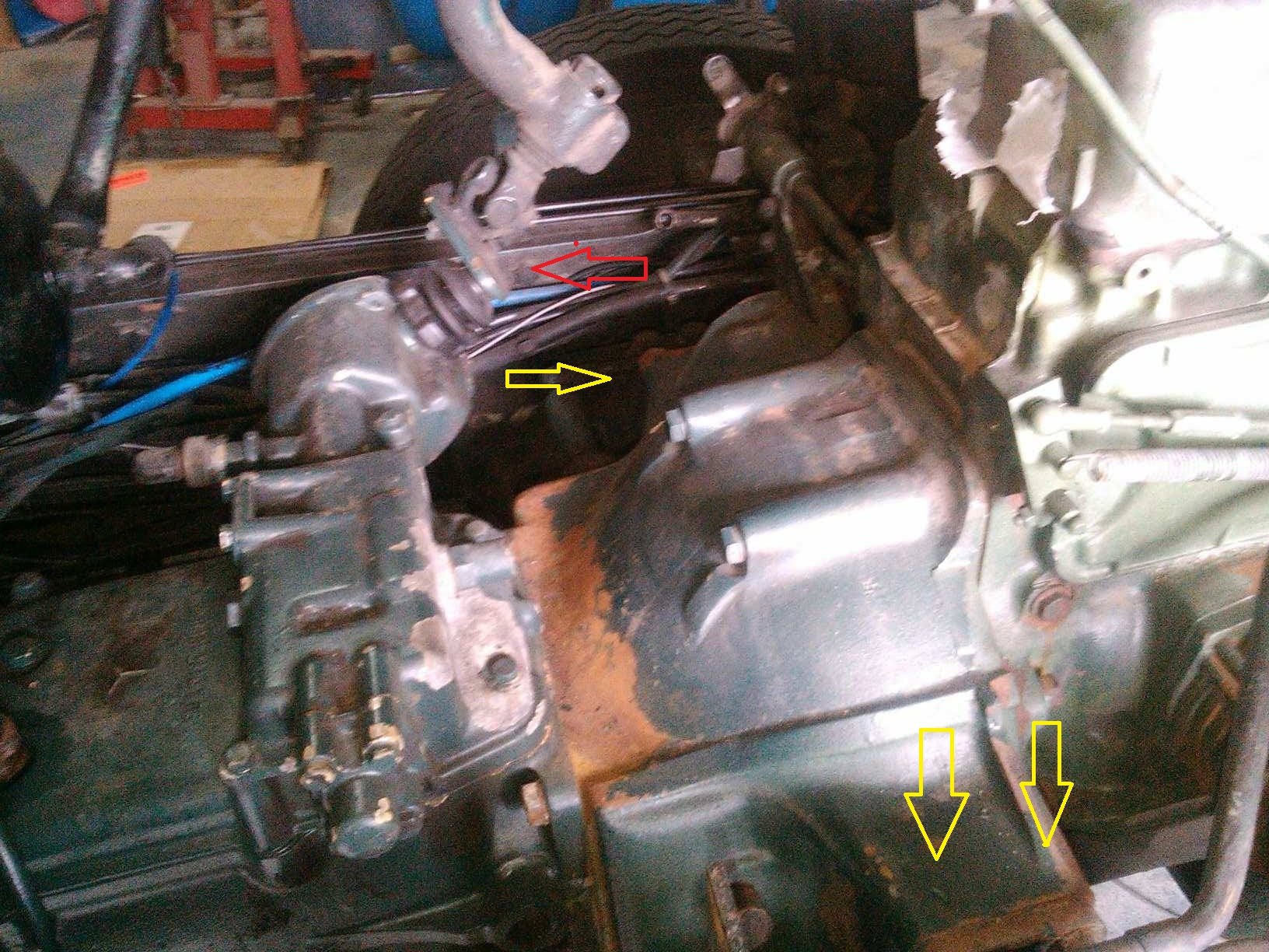

On the 1017AF the engine is supported on the front and on the flywheel housing side mounts.
The flywheel housing that i need (from a OM366LA) has the same holes for the side supports/mounts of my truck.
The yellow arrows show the G3 side supports
Are the side mounts on the GV4 gearbox together with the front engine mounts enough or is needed the back crossbeam support (same on Rossi MB1317AK)??
The gear selector rod must have a different play and place.
The GV4 i found has the gear selector under and the 1017AF has it up (red arrow on photo).
On the G3 the selector moves up/down, left/right but the GV4 moves left/right but the up/down movement is like a pendulum. Will my gear selector rod work with the GV4??

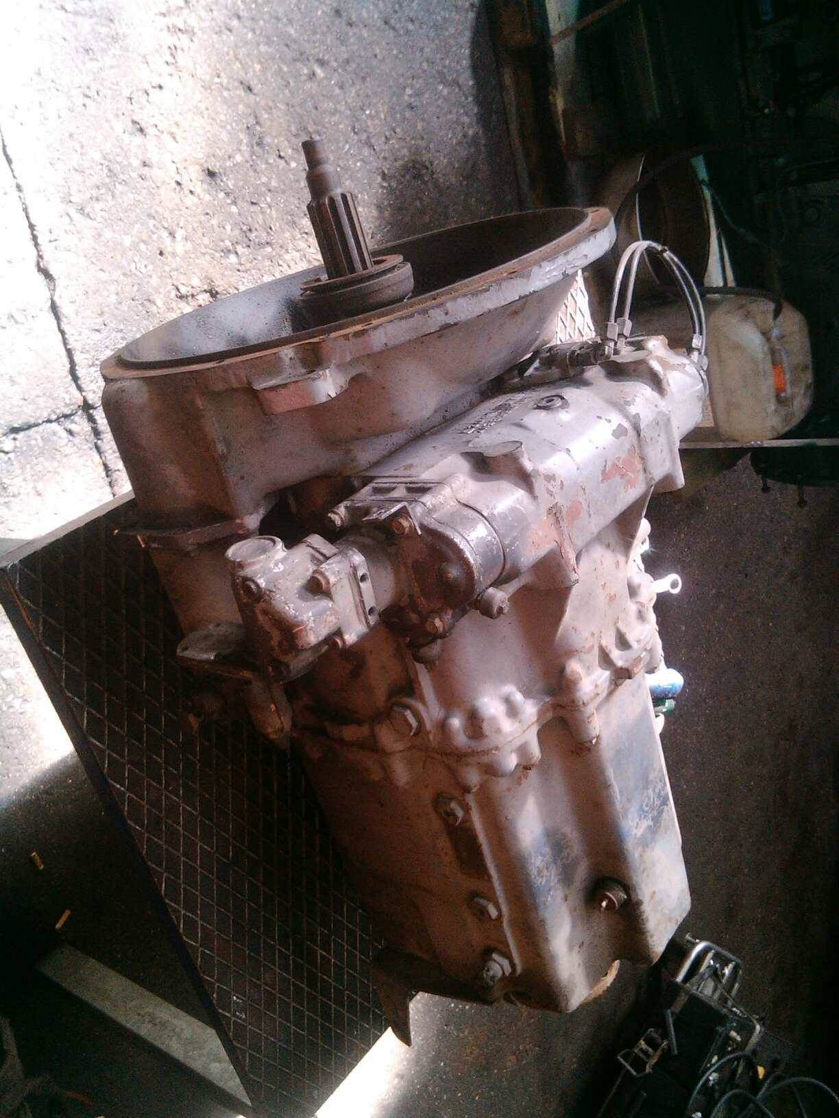

Also another worry about the rod...will be place for the rod to work on the side of gearbox?? Because of the gearbox side mounts there will not be a lot of space there.
The GV4 is 100cm long and the G3 is 70cms, so 30cms of kardanwelle must be cut.
The PTO kardanwelle is 33cms so i don´t know how will work.
The intermediate plate for the start motor will be a problem because the engine stop actuator is attached to it. The OM 366 has this part on the other side (lichtmachine)
Until i not sure, i will dig more..if someone has some ideas please share.
