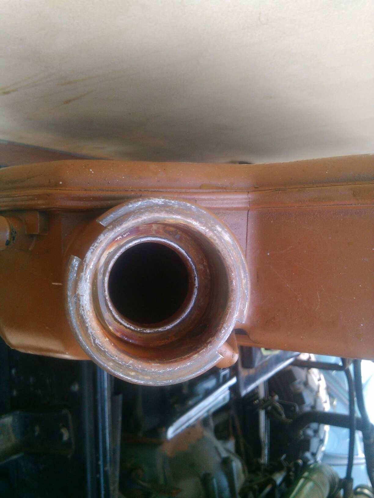

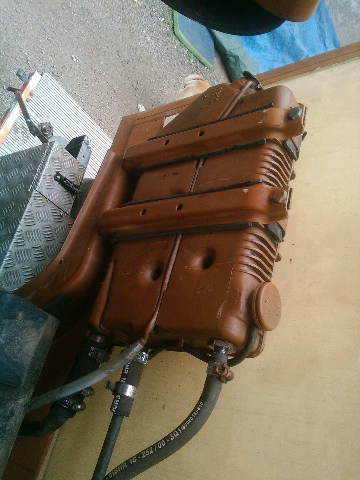

Hello..
My engine has a problem of pressure in the water system.
Some months ago i found some oil on the water system so i opened the cylinder head , changed all the gaskets, water pump (Febi), thermostat, new refurbished radiator, new injector nozzles. Did not touch the engine block.
I bleed the system as it says on the owners book.
But now the pressure is still there and the water pump started to leak from the under hole.
The temperature goes around 95º sometimes almost touching the 100º line. The radiator is on the top very hot and under is cold. (new thermostat 83º)
Every time i open the pressure tank (cold) there is water coming out.

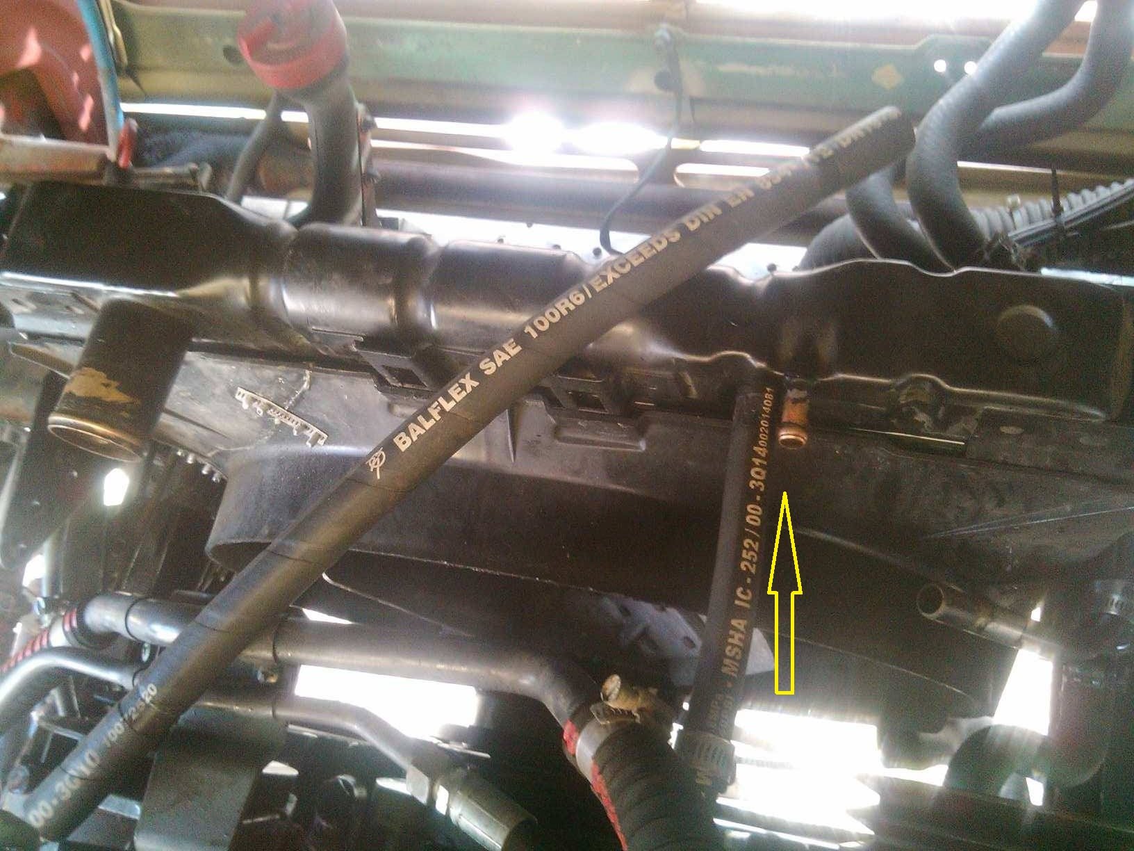

I question myself if the i placed the tubes correctly...the thinner tube (yellow arrow) from the radiator (up right side) goes to the lid of the pressure tank. Is this correct? It makes no sense. Only if it flows from the pressure tank valve to the radiator. I thought it was other way.
I am lost...don´t know where to start. I will change the water pump and bleed it good and test. Why the radiator is half cold half hot? The thermostat is new...and i see it working on the dashboard...temperature is oscillating while driving.
A friend asked me where is the hole to bleed the water system...i said i don´t know...i fill the pressure tank, heat the engine until the thermostat opens and then refill if needed. But then we found two bolts on the top of the water pipe. Is on the left side top, a hard tube that connects to the thermostat housing. Some one knows if they are used to bleed te system? Anyone with different ideas?
Google translate.

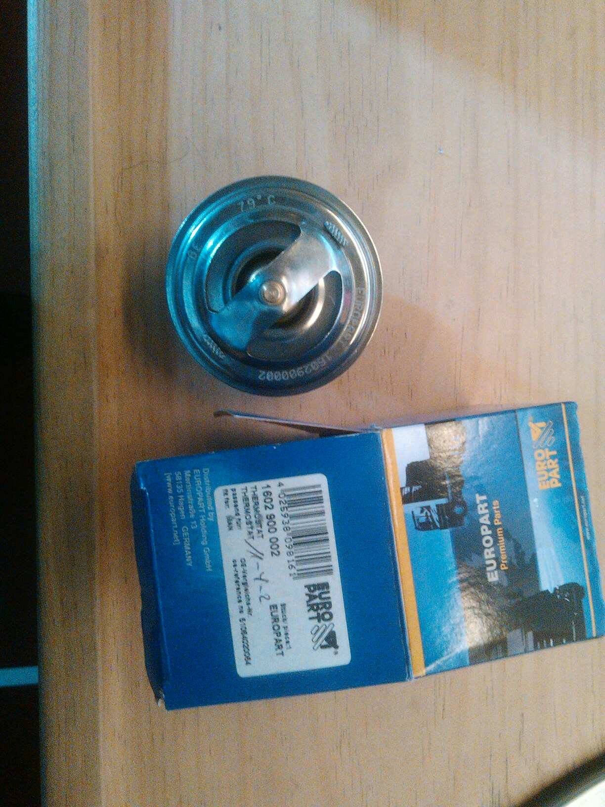

- You have built in a new thermostat.
In the past the thermostats had a little valve on the ground plate. Due to the costs most manufacturers cancelled this tiny valve. So now it can happen that air bubbles isolate the thermostat from the hot water preventing it from opening. I had this on my Unimog and it drove me crazy (and i know several similar cases).
My solution to that was to drill a little hole (2 or 3 mm) in the ground plate of he thermostat. You can see a little spot where the valve was normally located.
The air can go througt the thermostat even if closed (and he little amount of water that might go through isn't a problem) and everthing is fine.

Yes Sascha, the cylinder head was tested on the shop! They said the cylinder head was leaking from the o-rings of the injectors bed. New o-rings fitted and new gasket from Elring. All the other gaskets was Victor Reinz.
Yes Dapo, i fitted a new thermostat, and this one (Diesel Technic) has a hole already.
Ok the engine block can be cracked but then i would have overheat, lack of power and oil mixed on water..and that don´t happen. Or am i wrong?

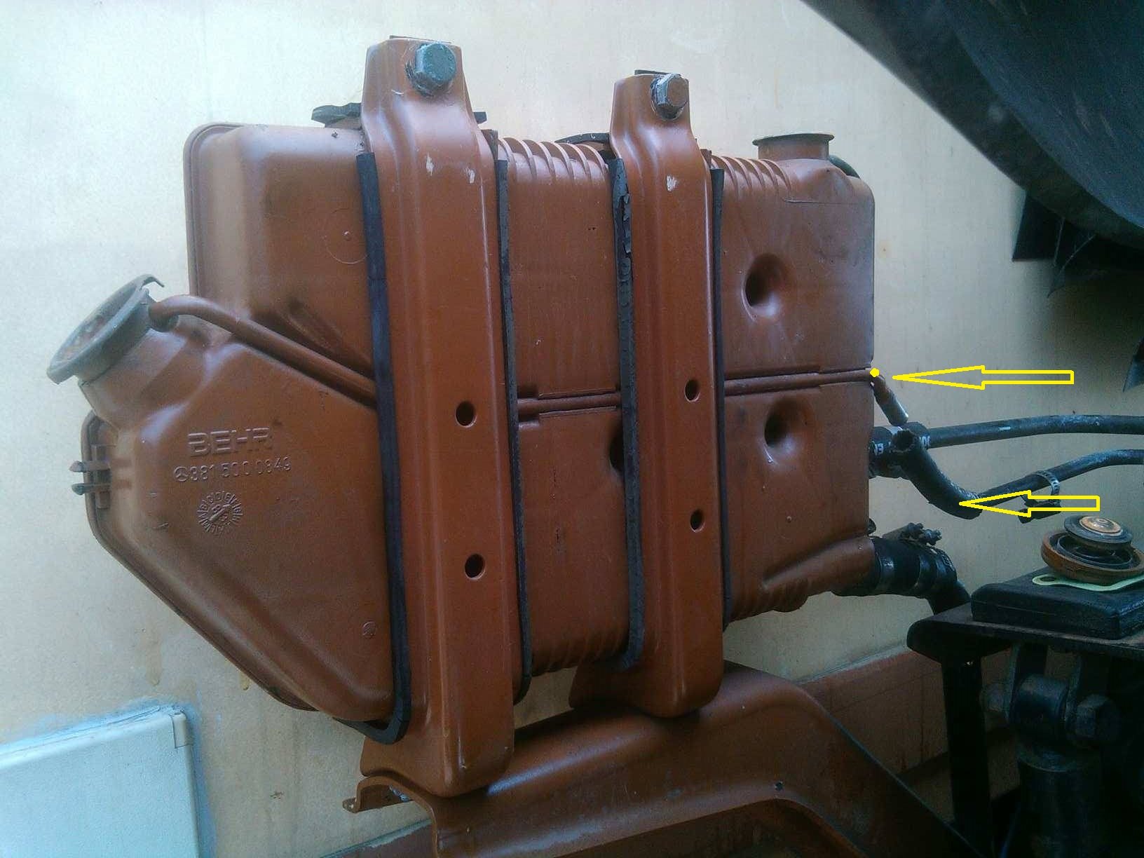

I don´t know if the thin tube from radiator should go to the entrance of the expansion tank, as show in the photos. When i put the lid on, the water from the radiator thin tube cannot escape. Is stuck between the lid (valve) When i open the lid (after warm and cool down) the water comes out spitting (pressure), and this water comes from the little hole (radiator thinner tube) not from the main water of expansion tank. I believe if this tube enters the expansion tank on other place (new hole i must drill) and drops inside, the pressure on the lid will go away.
My truck 1017AF had triple cabin (9 places) with expansion tank on top of the engine but when i bought it, i swap cabins to a sleeper (5 places) and install the backside expansion tank that i found in the Alfers und Sohn junkyard. I did it my self so i don´t know if connect the tubes to the correct place.
A friend mechanic is advising to drill a new hole on the expansion tank to place the thinner tube. I am lost..any ideas?
Thanks for the inputs.

So the thin tube from radiator is in the correct place?
It should go from the top right side of the radiator to the expansion tank lid (valve). It stays on the middle of the valve (attached photos).??
I find the pressure there...the water coming out when i open the lid (valve)is from this thin tube.
I can have a crack on the engine but first i must eliminate possibilities. I am almost drilling a hole on the expansion tank...and connect the tube in other place.
Thanks for the inputs...i would like to try all possibilities before open the engine again..!

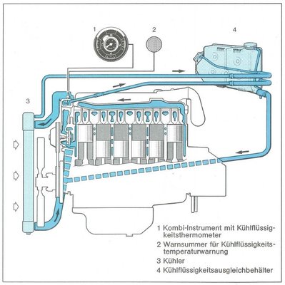

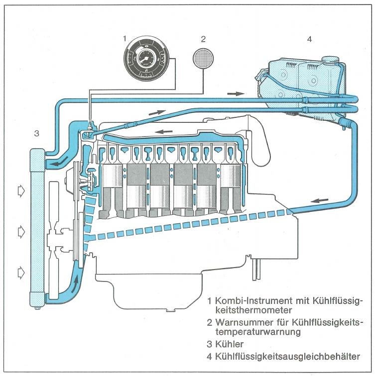

Your cooling system might be similar to this one (Mercedes-Benz NG-models of 1981):Mula Camion Sauvage hat geschrieben: ↑2019-09-18 17:08:36I question myself if the i placed the tubes correctly...the thinner tube (yellow arrow) from the radiator (up right side) goes to the lid of the pressure tank.
- Beiträge: 52
- Registriert: 2018-09-12 23:38:25
Re: Om 352A MB1017AF Pressure on water system.
Hey,
is possible to have a crack on the engine...i don´t discard it. Yet i don´t find oil or water mixed, but the temperature goes between 80º and 100º most of the time at 95º (above the parallel line of the floor). I am learning about this Co2 test.
Thanks Pirx for the great pic. (very useful) now i know that the cooling system was correctly done. But it came too late...
Today i drilled a hole on the expansion tank and connected the thin tube from the radiator on this hole. Is pressure tight. (Tomorrow i send photos). The valve (lid) exhaust tube is now going to the ground.
Went for a drive (18º outside), the temperature after warm was around 95º on a straight road with no traffic driving at 70kms/h. Sometimes almost touching the 100º. Never went on red line revolutions.
Stopped sometimes to check the temperature of the radiator, and up was very hot and down cold (something is wrong, tomorrow i check the thermostat). I see for the first time liquid coming from the exhaust tube to the ground...before i only had the upper exhaust pipe free and never i see signs of pressure (liquid) coming out.
When i parked back i could open the lid (temperature around 85º) and no pressure was there
perfect.
The issue of the cooling pressure system, i think is solved, but the temperature is still bothering me. If the temperature is 95º on a normal road and cold day i don´t want to imagine driving with temperatures outside 40º and going up mountain or on sandy roads.
Tomorrow will boil the thermostat to see if is working good. Maybe drive some kms without thermostat to see if the radiator heats evenly.
Thanks for the help, if anyone have other opinion i am glad to read it.

There is no more pressure on the expansion tank. Ok one problem solved but still would like to drive cooler. Maybe install a tropic thermostat. Anyone knows the part number so i can order.
Photo of the expansion tank with the new hole for the radiator tube. Now there is no pressure on the tank. The valve has the exhaust tube going down to the floor instead of going to the radiator. The one from the radiator is the new hole on the side.The valve is opening and liquid comes out from the tube.
Thanks
Thanks

So, after some kms the engine was still heating (around 95º). There was no pressure on the water system and the thermostat was working. I blocked the Visco Fan and the engine was running not so hot.Mula Camion Sauvage hat geschrieben: ↑2019-09-20 14:12:03Olá,
Tested (boiled) the thermostat and it start to open around 83º.
Went for a drive without thermostat and soon the radiator was hot everywhere. The temperature of coolant around 50º and 3 kms up hill went almost to 80º.
Conclusion:
Thermostat good.
Radiator good.
Water pump good.
Oil cooler good. Yesterday i took out the tubes and tested the flow and is ok.
Thanks
jenga
Installed a new thermostat (79º) and released the fan bolt.
Now is working around 80º and uphill is going until 90º.
Thanks for the good tips
jenga
