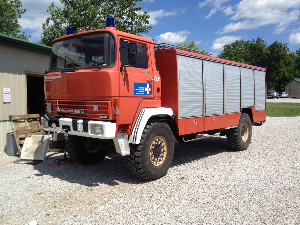

I have a Magirus Deutz D17 allrad 4X4 X-Swiss fire truck.
It have a 256 HP V8 12 speed trans and a ZF65? Transfer case.
I have up graded the tires to 14.00r-20 tires from 12.00R- 20 tires
On a long drive today with several extended runs at 90+ KPH I started to smell gear lube.
When I looked underneath I could see that gear lube has come out of the transfer case vent and the case was VERY hot.
The fluid was a little over full so that may explain the overflow from the vent, but is this much heat in the transfer case normal?
I am going to drain the transfer case and refill with Amsoil severe gear 80W90 Synthetic.
If this is normal has anyone come up with a way to keep it cooler?
Was thinking about a fan and ducting and some bolt on cooling finned......
