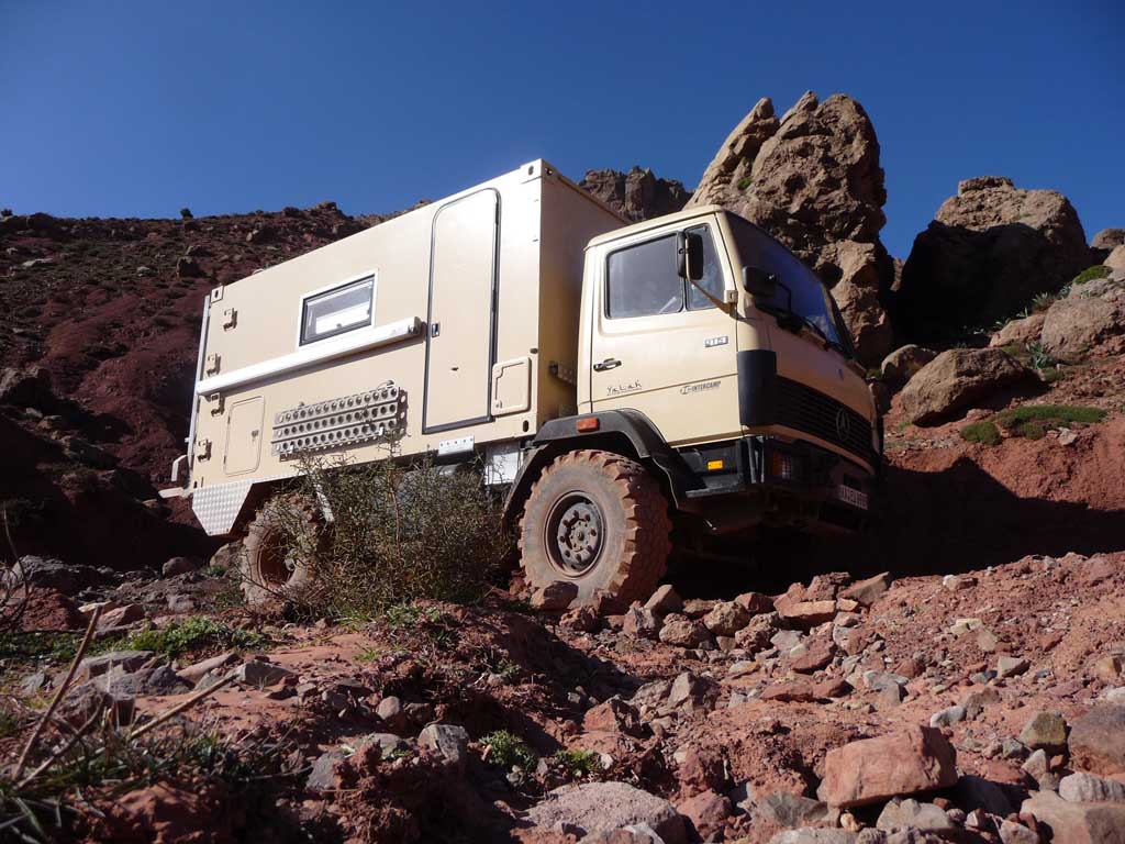

I also have a 914 4x4 permanent. With 365/80-20 max speed is 100 km/h with 2800.
My fuel consumption with permanent 4x4 ist aprox. 23ltrs but I hope to bring it down by 1 or 2 liters through improving the fuel injection. Maybe another liter through a more aerodynamic roof rack.
If it would be helpful for you for the czech TÜV I can email my vehicle registration card to you so that you can proof to them that these wheels are common on MB 914 in Germany.
To clear the space for the bigger wheels you have to cut parts of mud wing as well as the lowest step of the ladder. See picture below.
